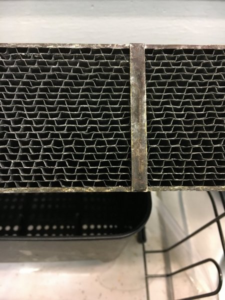

    Here's my PH cat after 4 cord of wood since the last bath. I've vacuumed it, so what you see still on it isn't coming off easily. I'll do the vinegar spray method, rather than soak.

    Did it look like that before the last bath, and did it come off? I would have to see it in person, but that looks to me like the coating is peeling. I've seen it on both steel and ceramic cats, but that's about the worst I've seen. As long as that doesn't go all the way through, and the cat is still working well, it's not too big a deal, I guess.

    That looks like ash to me..not the coating peeling off.

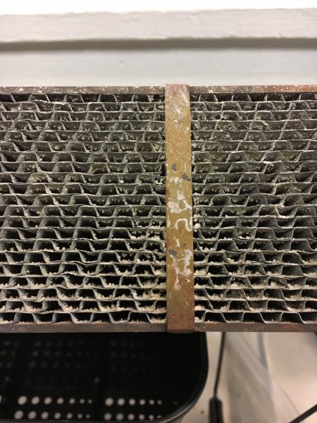

    Here is the PH cat cleaned up a bit. I didn't see any signs of the coating peeling, just ash accumulations. You might see a few spots where there is still some ash stuck on. I think next time, if I remember, I will try a soak/dip - the spray gets most but not all of it off.

    Good deal. That stuff just looked a little different than the ash I usually see. Maybe it is deposited a little differently on the DuraFoil. I have one coming, so I'll see soon enough...
