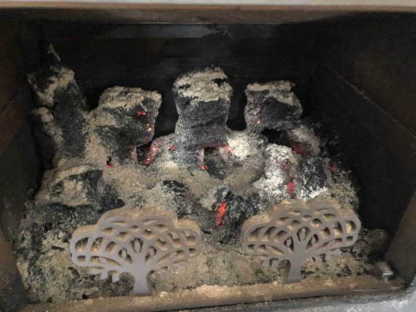

    I forgot the picture. As you can see, there is still quite a bit of fuel left. Just need to open up the air and I probably have another hour or more before I have to reload if really want to stretch it.

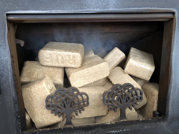

    Here is what 36 bricks look like just tossed in for a hot reload. I have put in 40 or more in the past, but I am not interested in taking the time to stack neatly in a hot stove if there is no need to.

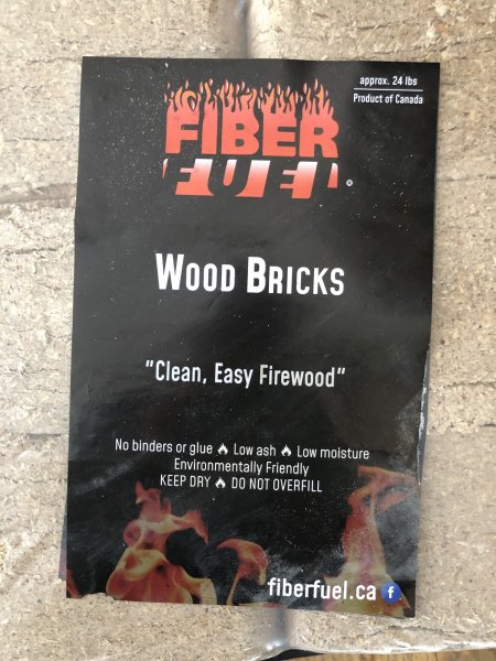

    The two pallets I have bought were both “Lewis Fiber Fuel” and they came from a local chain called Country Max. Lewis has a dealer locator on their website, but if they are not available near you, there’s a good chance another brand will be.

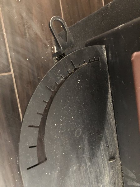

    You said "I cut the air input back to about 4 notches (1 small notch below the first big one". Help me out a little. My AS goes from 0 to 4 with 4 being wide open. With mine I believe you are saying 1 small notch below 1. Is that setting any different than your night settings for split wood?

    The bricks I have are nothing but compressed saw dust from a trim and molding factory in Canada. Look for “no binders or glue” on the label.
    Here is a picture of the IS control. The AS is different as is every chimney install etc. so you will need to find your sweet spot. As for is it the same as with splits, for the most part, yes. The bricks are more consistent load to load, but the outdoor temp and winds will impact where it needs to be set as well.

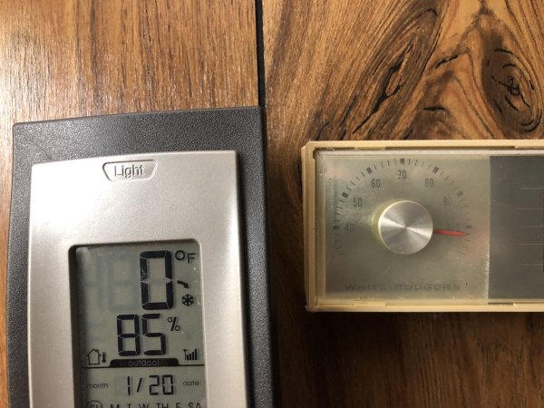

    Ok, update and pics... yes I finally made it to the 102 degree club. Zero degrees outside, 102 in the stove room.
