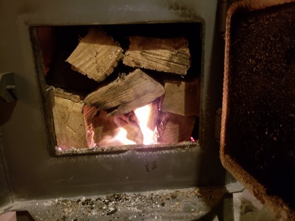

    I just reloaded my AS.
    6:10 I raked the coals and spread them so that there was a large pile near the door, and an equal pile near the back. Leaving a small valley in the middle completely clear to the grates. Then I opened the ash door and burned down the coals for 5 minutes.
    6:15 I loaded the stove with ash. You cant see it, but theres a split in the top left corner too. I had good flames before I was finished loading it. Then closed the door.
    6:15 500F STT shut the ash door and bypass in that order.
    6:20 I throttled back to 3
    6:30 throttled back to 1.5 STT settled to 480F it will sit there for a bit until the secondaries start firing, then the temps will climb a bit, and I will shut the air down to .75 (or I could do that now if I was going to bed)
