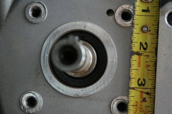

    I just bought a Honda GX 270 to replace the crappy Briggs engine on my splitter. My problem is where the bracket that connects the engine to the hydraulic pump. The old bracket holes on the engine side were 2 1/2 inches apart like in the picture.
    The new Honda spacing is 3 1/2 inches. The crank on the Honda is also 1" but I got that covered already by buying a new jaw connector with a 1" hole.

    Hydraulic pump mounting bracket is yielding some results. My crankshaft is also longer so I'll need a longer bracket as well.
    First thing I'll have to do is bring the old bracket inside and take some measurements.

    or make spacer(s) for the exra length- red neck way cut off shaft. Current bracket / mount , whatever -is there enough material to slot the bolt holes? Course having a machine shop at my disposal means none of this is a problem. between the various mills, grinders,welders dang near anything is possible. trick is to keep it square ( shaft center-line alignment).

    Not enough material. The existing holes are right near the outer corners of the mount. The last thing I would want to do is cut the crankshaft. Maybe if I was lost in the jungle and doing that was my only way out...
