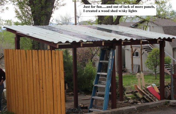

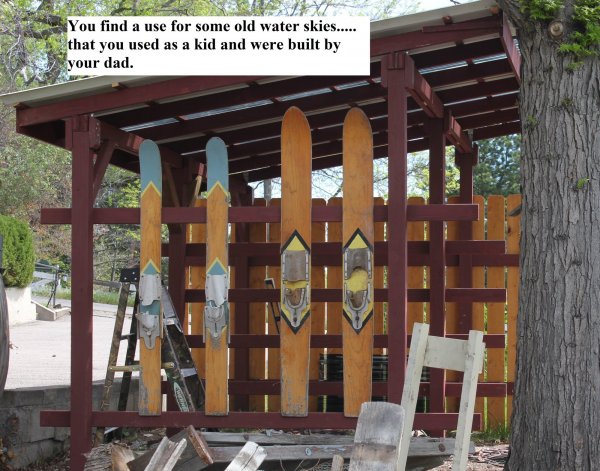

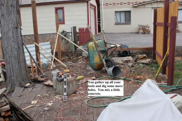

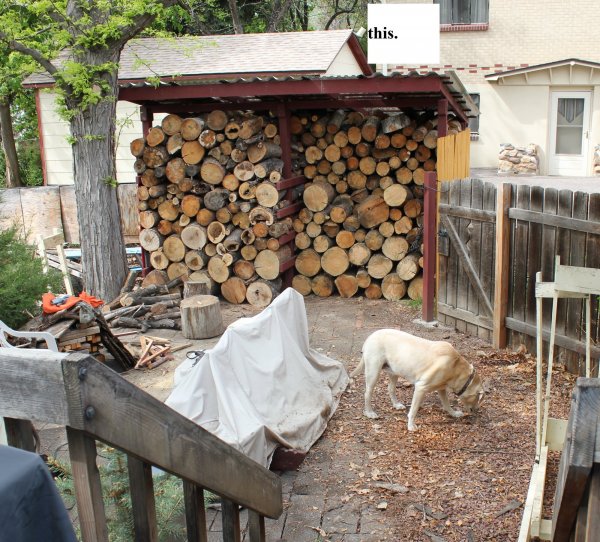

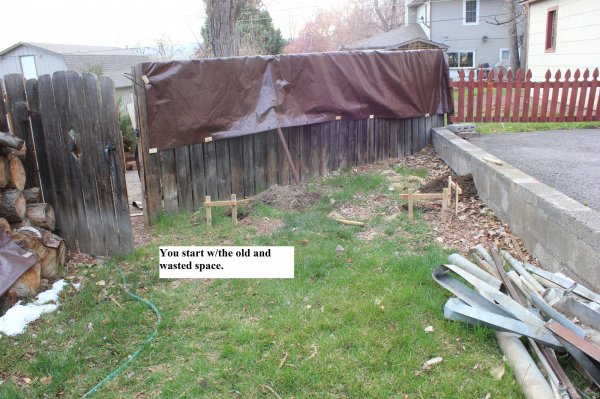

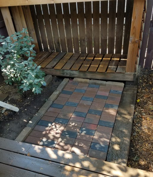

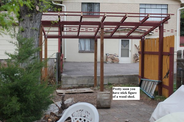

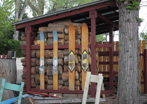

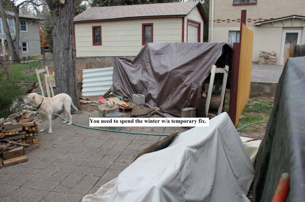

    Here you go. 3 weekends.

    Very Coooooool!!!!! :cool:

    Dave is right, very cool. I would have put pallets on the ground for some more airventilation. Those Waterskies are wicked!

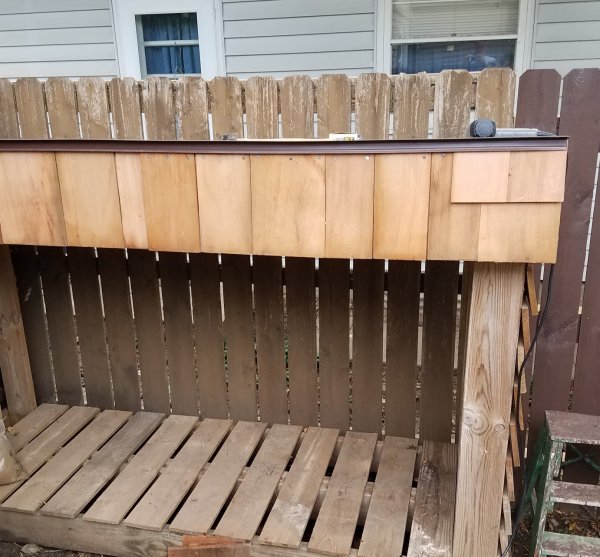

    Here are a couple pics of what I did.
    I started with 2 classic 2x6 wood racks, 8' long, 4' high. I set them on blocks and screwed on a floor of old treated fence boards, making a floor about 34" deep (I cut 16" lengths)
    I used the same boards and installed them on the exposed ends as siding.
    I built a simple pitched roof frame and lifted it onto to the ends of the upright 2x6. To dress it up I grabbed some extra cedar shingles for the front and sides.
    I finished up the front since that pic, but now I'm working on shingling the roof.
    I only store seasoned wood so air movement isn't as critical

    In Colorado, it is so dry, as long as the ground stays covered, you don't really
    need the pallets. I do put some old cedar fence down. Once that bentonite clay
    drys, it will suck the moisture out of the wood. That's also why it is not split.
    I split it as I use it. Since I am now on the 5yr plan, it is plenty dry when I need it.
    The blue ones were mine. When we started skiing, I was too small to get out of the
    water on the "adult" skies. So, my dad made the small ones for me. As I grew up,
    I was the only one who could ski on them. It was pretty cool having my own skies.
    When we got rid of the boat, the skies were put in the attic for 40 years. When I moved
    home and we refurbished the house, I just couldn't throw them away. They are
    perfect for the wood shed.

    Thanks! The shed holds 5 cords.

    I see, pallets is the 1st thing i think of these days..just couldnt help myself but now i know :flipeggs:
    I guess i would have kept them too and they are perfect on the woodshed.
