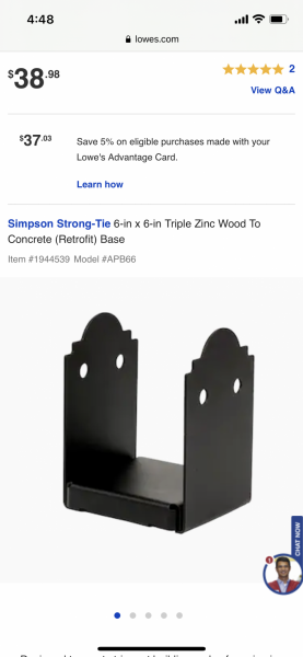

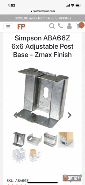

    Are you going to use some sort of concrete anchors that keep the wood posts isolated from the concrete so thy do not wick up a lot of moisture that may cause some rot?

    Good idea. As the posts are round and not uniform, I'll need to do some thinking about how to work with the anchors.
