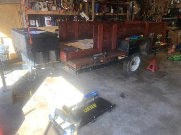

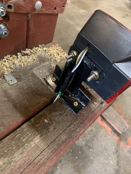

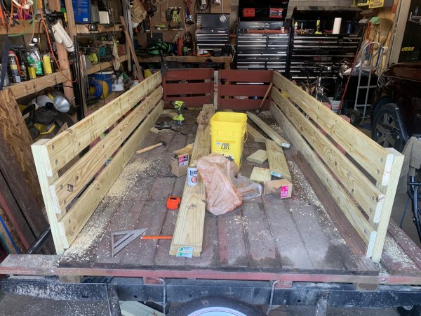

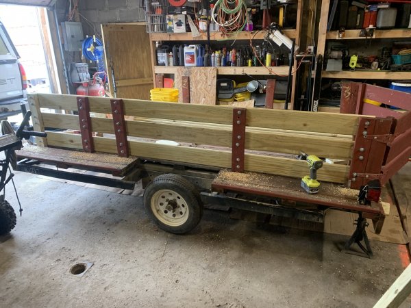

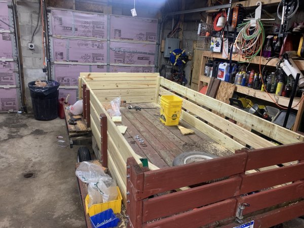

    I built this on an extreme budget 15 years ago with osb sides and after setting mostly ignored for the last 2 years at my parents house I decided to fix the old girl up. It’s coming together pretty nice so far. She will haul wood again soon.
    New lights
    Make New light brackets
    New tires and wheels
    Pack bearings
    New trailer sides
    New fenders
    New tongue box
    New chains
    New tie downs in the bed.

    Also, great call on the spacing on the side walls…increased airflow means speeding up the seasoning process! :D
    Seriously though, the trailer looks great—nice work.

    Thanks I was going to do the front like that but I had enough scrap to make it solid. Less mud all over everything in theory.
