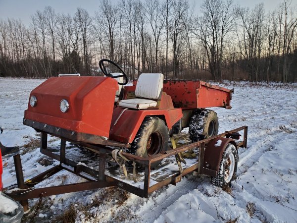

    The PUG had been under 10+ feet of water twice in Hancock Co. MS. during Hurricane Katrina and then Rita in 2005. It was gifted to me by the Patriarch (Mr.Vincent) of the family who owned it at the time. He was tired of changing oils and fluids in all their rental equipment. This was on the back burner for him.
    I left the MS gulf coast in May of 2006 after 8 months of volunteer work and as I was loading my trailer he came out and said "looks like that thing will fit" while pointing at the PUG. I was ecstatic! We named it the "MV" in reference to the owner.
    Once home I found the rear end was locked up solid. The pumpkin had barnacles growing inside. Mr. V had changed engine oil after both storms but front and rear differentials had remnants of the Gulf of Mexico inside. It took a few months to get parts from Wisconsin, but it was running by fall.
    I used it a lot for wood gathering, hauling dirt for the backstop on my range and the occasional deer retrieval. That came to an end a few years later with a loud knock, then nothing. Salt water had pitted the crank and bearings, not to mention corroding the aluminum parts of the engine.
    It sat broken for years, as I was getting wood from a tree service and my backstop was completed. It wasn't a pressing need. Still, it bugged me to see it not in service. Finally, I found a nearly exact engine and had a guy swap it out along with repairing brake lines and power steering lines and a few other odds and ends. It was finished today.
    While wood gathering will resume as my tree guy has stopped supplying now that he has room to process and sell firewood. It sounds like sap gathering is going to be added to its duties as well. My boys will likely be tapping trees in our local village this coming season. The owner of the maple farm is supplying the tank, transfer tank (dont have to raise the buckets over your head) and all the taps and buckets plus buying the collected sap from them.
    It's good to see it back in use and even better to be able to actually use it myself. I think it will be getting a fresh coat of paint this summer and the lettering "MV" in honor of the previous owner who has since passed away. He was a great man.

    Hydraulic dump, uses an automotive power steering pump for both the steering and dump box. Capacity is 1k pounds (+). Not sure what the power steering pump is from, but the brake master cylinder is off a 1964 Chevy pickup. C-10 maybe?

    Not sure what it had from the factory. I've seen a few with 8hp Tecumsehs. I replaced the Kohler 18hp opposed twin that was in it with the same engine, slightly newer generation.
