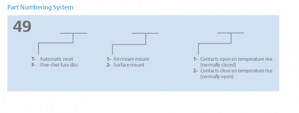

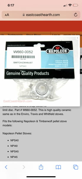

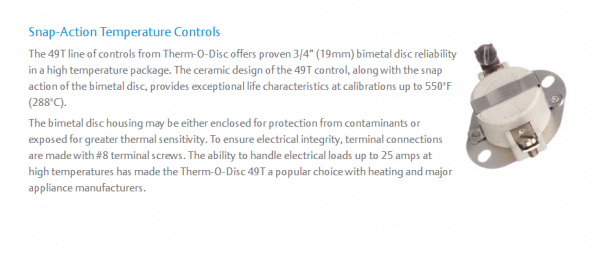

    So having spent the majority of my working life in manufacturing, I know quite well the mark-ups involved. and only do so. Did a little digging first thing while sipping coffee trying to wake up, searched W660-0052 and found a picture that showed some numbers on the disc itself.
    Those numbers indicate an Emerson 49T series Therm-O-Disc where 1=air stream mount 2=close on rise.
    Emerson Therm-O-Disc 49T12-xxx? the last digits being the major rub. So far I've not even been able to find a list of temp ranges never mind any p/n's. Everything is carefully steered to commercial/manufacturer application only, and not retail sale.
    For those that are not familiar, that is pretty much common practice in the industrial world. That way you have no choice but to contact the manufacturer of your piece of equipment and pay a incredibly stupid price.
    I have however not given up, just out of sitting on my butt accomplishing in the morning time. If I were still working I would just walk into engineering and pull the catalog off the shelf. Yes there is still such a thing, and more often times than not, much quicker.
