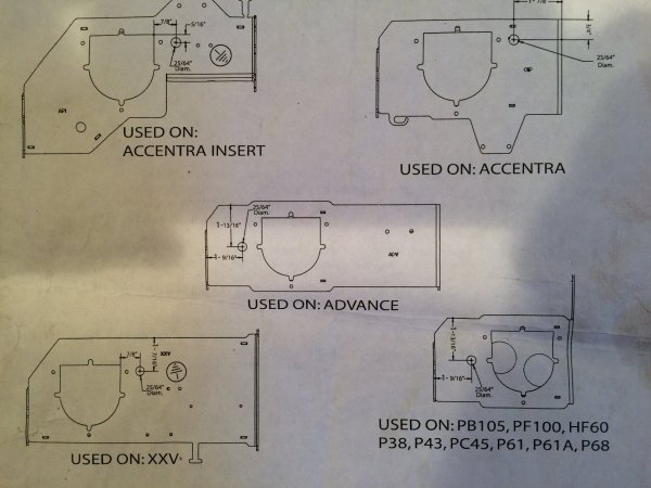

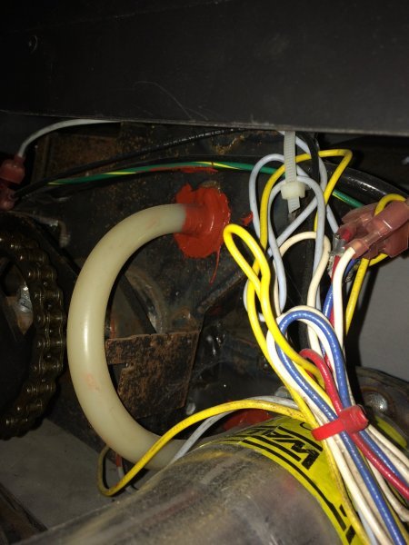

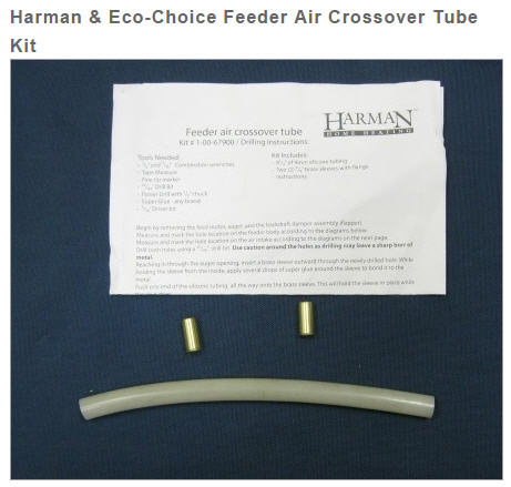

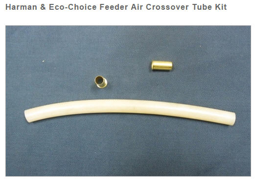

    The "Gummy Fix"' is a high temp silicone hose from the base of the air inlet flange to the back of the feeder welderment. Search on Harman Air Crossover Tube Kit - Harman Part number: 1-00-67900
    Includes 8-1/2" of 9mm silicone tube, two 3/8" brass sleeves and instructions.
    It prevents the auger and burn pot from caking up with black carbon and sticky black creasote. Hence called the famous "Gummy Fix"
    For Harman Pellet Stoves:
    Accentra, Accentra Insert, P52i Insert, Advance, HF60, P35i Insert, P38, P43, P61, P61A, P68, PF100, XXV, PC45, PB105
    Heatilator Eco-Choice Pellet Stoves:
    BH60, BH105, BA100
    See Harman Accentra Insert gummy fix pic, see yellow arrows below:

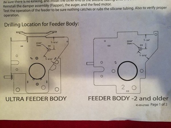

    Hello Don,
    I'm interested in the "fix" would you happen to have a complete download of the instructions, seem awful expensive for a piece of 9mm tubing and a couple of brass fittings.
    i see your drilling instructions but would like to have the instruction sheet.

    It is a kit sold by Harman
    The instructions are attached.
