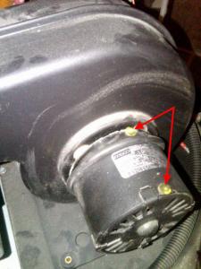

    The piccy shows the normal factory type exhaust fan motor.

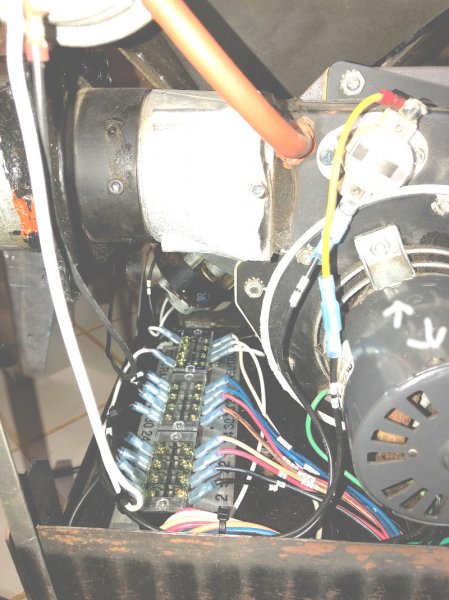

    (Don"t pay any attention to all the extra wiring...I installed a custom controller)
    If your stove has the same type of fan motor SEE THE TWO ARROWS in White
    Use some 3 in 1 blue top bottle oil
    2-3 drops in both little holes
    Your stove may have rubber plugs in the holes....remove the plugs and oil the motor.
    Oil at least twice a season....I oil mine every month or so.

    Get some pics please of the fan motor and post them. CLOSE UP AND WIDE SHOTS
    The Adv plus is a bit different than the earlier Advantage models, so pics will help figure the issue out.

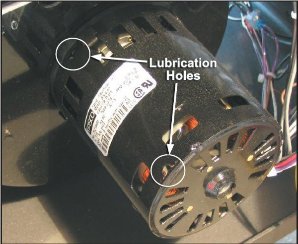

    A little help to see those oil ports, and the recommended oil for electric motors:

    The convection fans usually used ball bearings and don't require oil (Check to be sure)

    It is very common for the draft/exhaust fans to get sluggish if they have not been oiled.
    What happens is the as the fan warms up it will loosen up some and run better, but after a while even this will not help... OIL is the key.
    Let us know what ya see....

    Actually, the exhaust fans are the ones coming with ball bearing motors for quite a few years now. Both motors in the pics I sent were convection fan motors.....convection fans usually had to be oiled (sleeve bearings), but in the past 5 yrs. since I last had my 10-cpm, maybe now those are ball bearing too????
