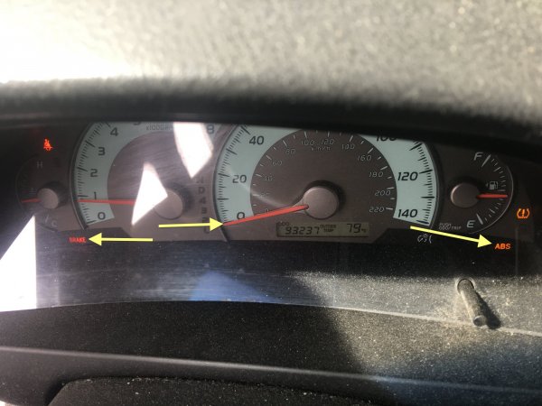

    This has been happening intermittently on our 2007 Toyota Camry 4 Cylinder 4 Door Sedan. If I stop and turn the car off with the key and then turn the car back on then it is fine for a while?? See Yellow arrows in Pic Below - click to Enlarge.

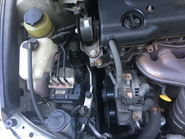

    At first, I did not see the brake and ABS lights so I put in a new speed sensor. This car has one sensor in the top of the transmission under the air filter box. It is just held in by one bolt.

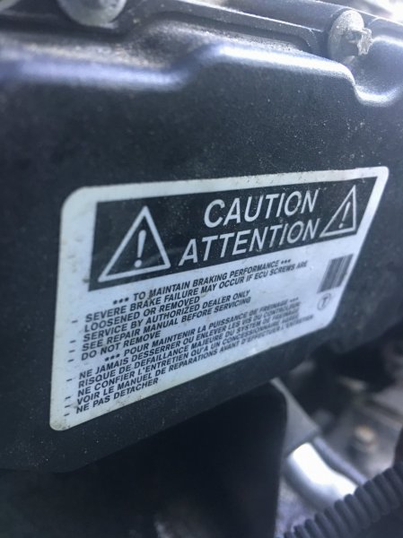

    Then I saw on the web that if the 5th digit is E or K, in my case E then it means the ABS Control Module has the skid control option and this brand new part to fix the problem is $2100 and takes a few days to get!!!

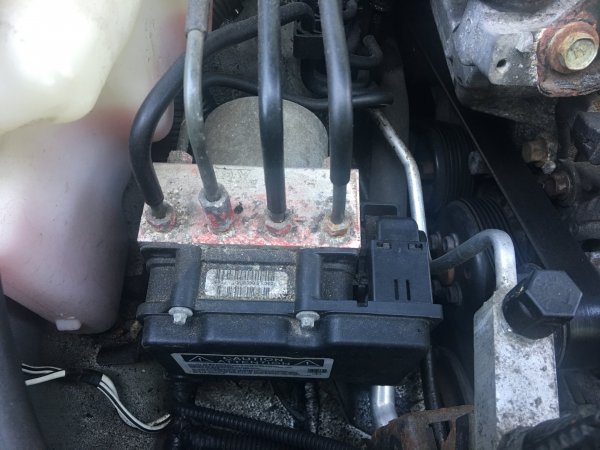

    There are 4 E-5 Head star bolts holding the module and a lever that pulls up to disconnect the Ziff connector on the side of the module.
    On this car the brake lines do not go directly into the black electronic part so replacing this part is just plug and play!!

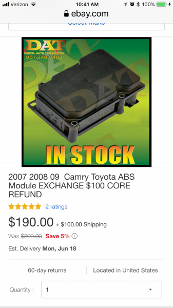

    The Auto Parts stores sell the part for between $400 - $600 plus $200 core charge and the rebuilders can repair it for $150 or sell a rebuilt one for $190??

    Pic 1 - Shows dash board problem
    Tachometer going but speedometer dead and brake light and ABS light both on???
    Pic 2 - Driver’s side of engine
    Pic 3 - ABS modulator
    Pic 4 - Black ABS modulator Control. See star bolts.

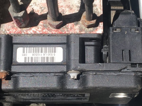

    Pic 5 - Rebuilt module

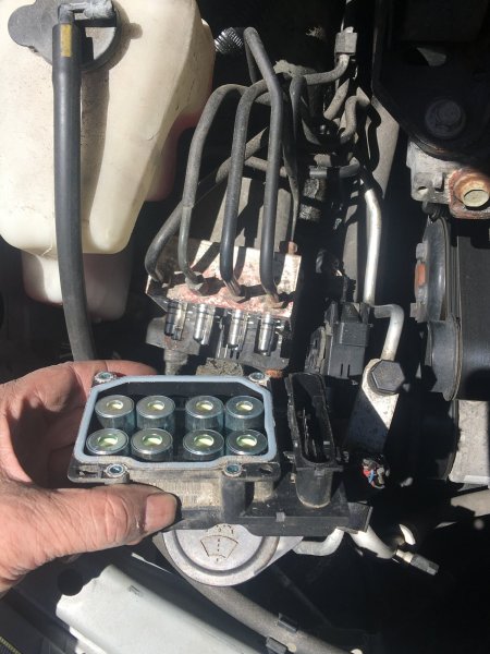

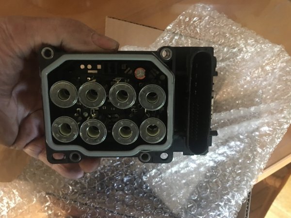

    New ABS modulator Control came in 2.5 Days from Cali. Had to buy an E-5 Star tool for the 4 bolt replacement. Disconnected the negative battery terminal and did the replacement.
    Speedometer is working and AbS Light & brake light is off!
    Now I have to get my $100 core deposit back!
    The new part came with a prepaid return label!
    I recommend DAT in Cali :)

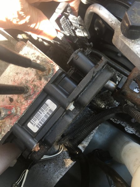

    Pic 1 - old black ABS control module
    Pic 2 & 3 - New Black ABS control module
    Pic 4 - new model bolted in
    Pic 5 - new module with electrical connector

    It has been a good car but the price of Dealer parts are out rages! I am glad I found the rebuilders in Cali, very nice to work with. I texted Joe a few pics and the VIN number and he made sure they sent out the right part with a prepaid return label for the old core!

    Yes, even this one supposidly is matched to the 5th digit in the vin number and I gave that info to the supplier. I think in this case the difference was very little! I was lucky that no brake lines went into the control module like some cars so no brake bleeding was needed either! Just plug and pray! LOL

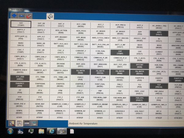

    I miss those days of auto repair. Heck even just swapping out a E prom from the ecms was cake compared to what they are doing to them now. I am a Technician for Ford / Lincoln and stuff is just outrageous now. Everything has a programable module now. I have seen as many as 130 programable modules on some vehicles. This screen shot is page one of three of the stuff that I can monitor live to find out what is wrong with a vehicle
