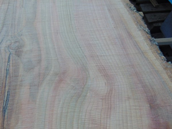

    I have an Alaskan and like it very much. It's very light and easy to use and adjust. You'll loose about 4-5" of bar length with the clamps. Also, I just use full skip, full chisel chain and have great results doing so. Square filed cuts and lasts best but if you can't, round at about 10 degrees works well. This pic shows the finish.
    One thing I would also recommend, if you do go with the Granberg, get the newer updated brackets that are cut from billet.
