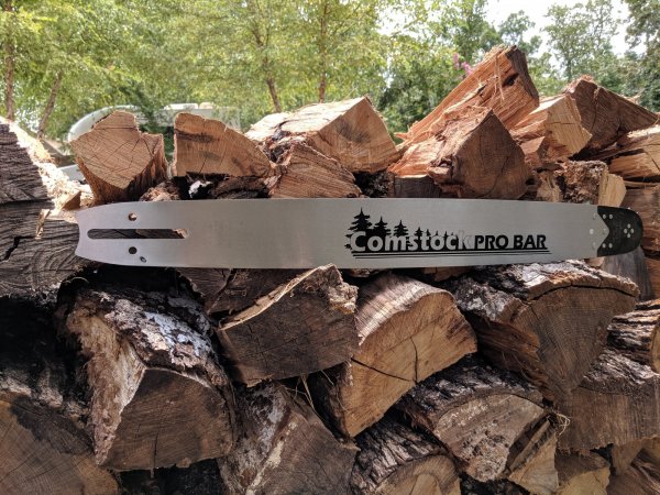

    Ordered their 24", it arrived yesterday with a free chain.
