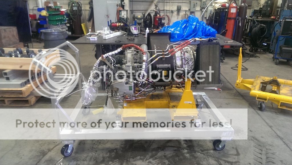

    had to design and build a cart to hold this this, who knows what it is?? Actually i have to fab 6 of them

  9. Elderthewelder

    yes, but for what purpose
    yeah its a engine, but not for a helicopter

  10. Elderthewelder

    ok, its an APU out of a 737 airplane, our mechanics are pulling them out and putting them on pallets, customer does not like that, wnats something hard mounted and mobile

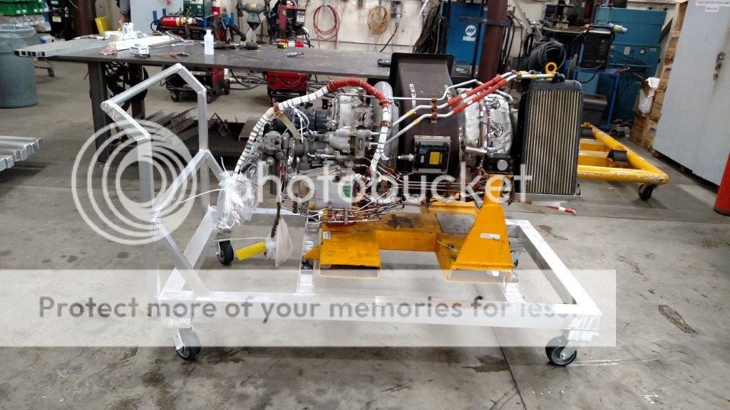

    The cart is made from 3" aluminum box tube 1/4" wall, casters are bolted to 5" x 1/2" wall aluminum c channel, channel is welded to a plate on bottom of cart
