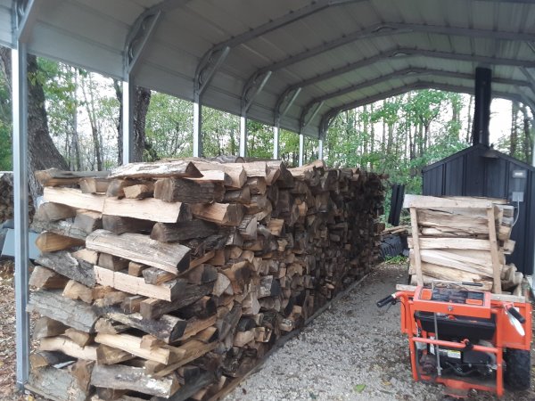

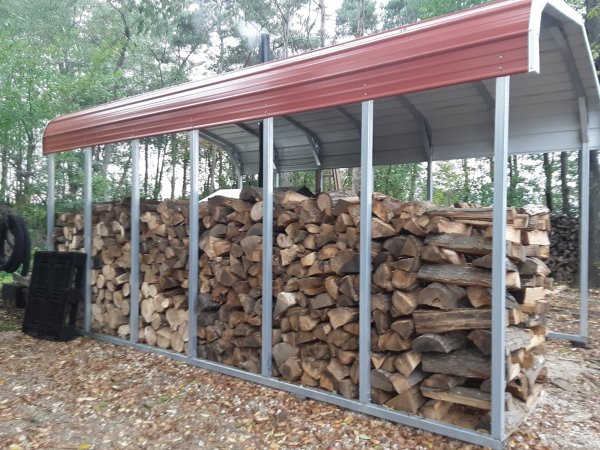

    This year a bit different, had everything split in spring, loaded up the boiler shed in fall with about 9ish cord, 3 poplar, remaining ash (10'×16'×8') right next to the boiler (really nice!!!!!!)

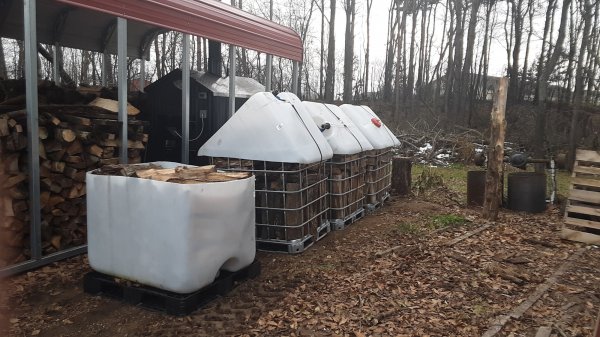

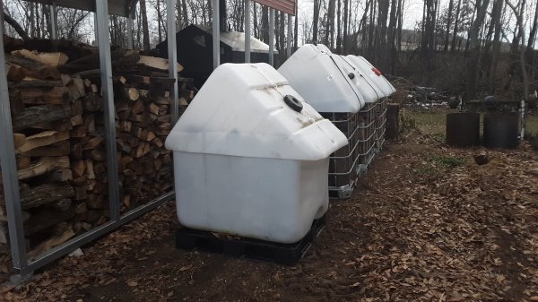

    Backup plan, 5 cords stacked on pallet bins that can be brought in with bobcat when needed
    So far used roughly 2.5 cords of poplar as it hasn't been super cold yet and getting decent burn times (load it twice a day) weekends get about 20 hours or so between reloads
