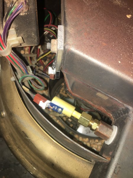

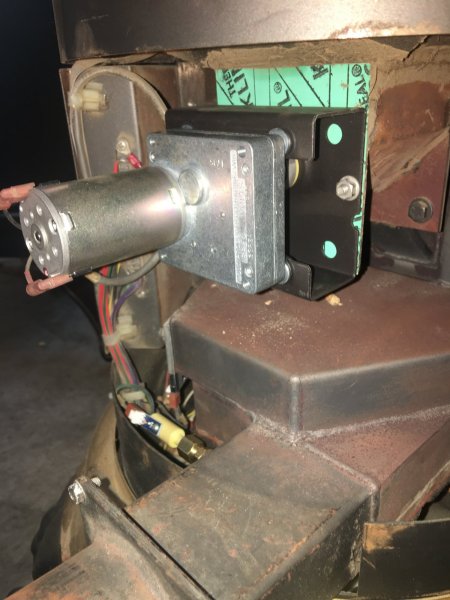

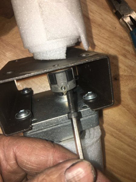

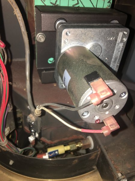

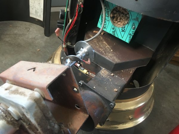

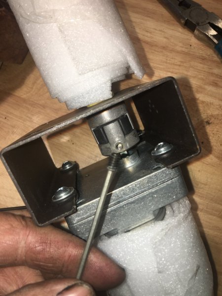

    Today we pulled the auger feed assembly and before we put the new assembly in we changed the T1 and T2 sensors and installed the upgraded set screw in the auger motor collar for a stronger connection for better pellet feeding.
    Sounds better but still a little whirring noise. Any thing else can be done? Still not working on High?
    Pic 1 - Skanky old Auger feed assembly has some rust
    Pic 2 - New T1 & T2 sensors

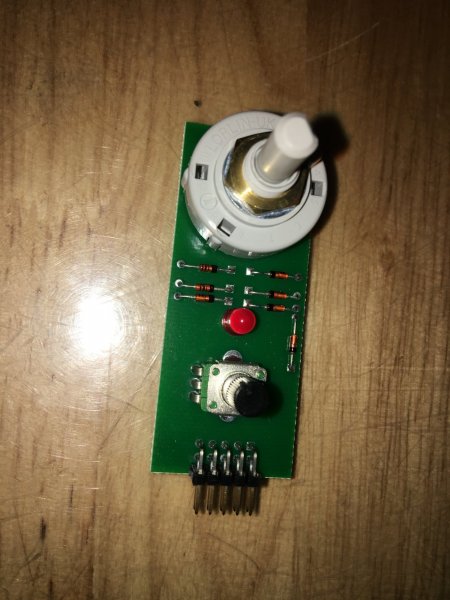

    Since the whole auger motor assembly with new brushes was replaced, I conferred with Thelin (I.E. Sierra Products now) and the plan is to replace the old rotary knob Potentiometer Circuit Board. (10 pin board not the slightly newer 8 pin board). That part was on back order at Thelin until the first of this week. Therefore I just got it in the mail today. :)

    New Pot on Circuit Board fixed it!
    See video.

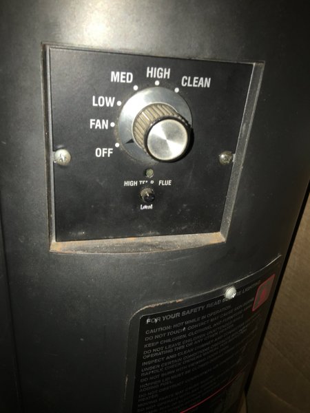

    I replace the board with the pot and showed a pic,
    It is the heat selector pot. See both pics

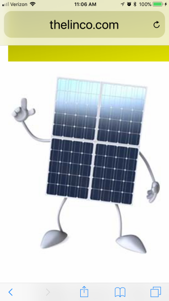

    This pellet stove has all 12 VDC motors and red and black banana jacks to plug in a deep cycle marine battery.
    You can also hook a solar panel array and live off the grid with heat!!!
    See Solar Panel Fact sheet.
    http://thelinco.com/wp-content/uploads/Solar-Panel-Fact-Sheet-MP-REF-SLS-202-Rev.-A.pdf
