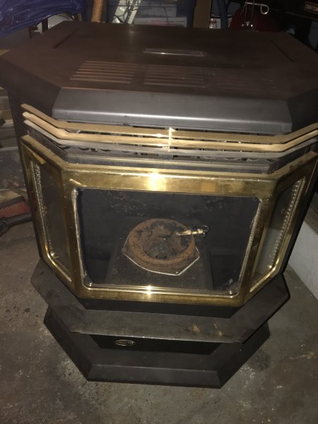

    Hello

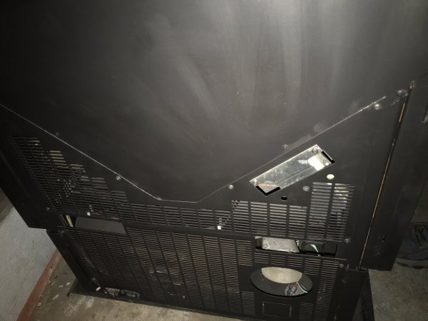

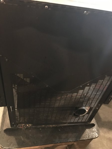

    The Aladdin is actually called a Quadra-Fire 1200 and has the control box under the hopper on the right side and no carry slots in the back panel
    The Quadrafire / HHT called the Quadrafire Classic Bay CB1200 has the control box in the hopper on the right side and 2 carry slots in the back panel
    Any other differences besides the tag that shows the manufacturer?
    Pic 1-4 Aladdin Classic Bay
    Pic 5-7 Quadrafire / HHT Classic Bay

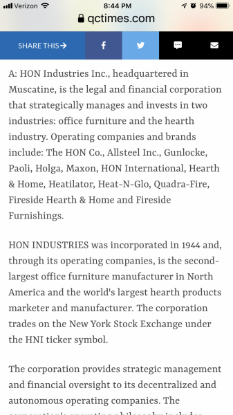

    Aladdin was the original company that made quadra fire stoves. They were bought out by quad, who was bought out by hht. who was bought out by another company. kap

    Who bought HHT? That is news to me?

    Hon industries. Years ago

    Jesus...we use Hon cubicle furniture (Allsteel) and chairs and such...who knew they have their hands dipped in all these other ventures.

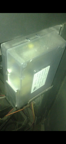

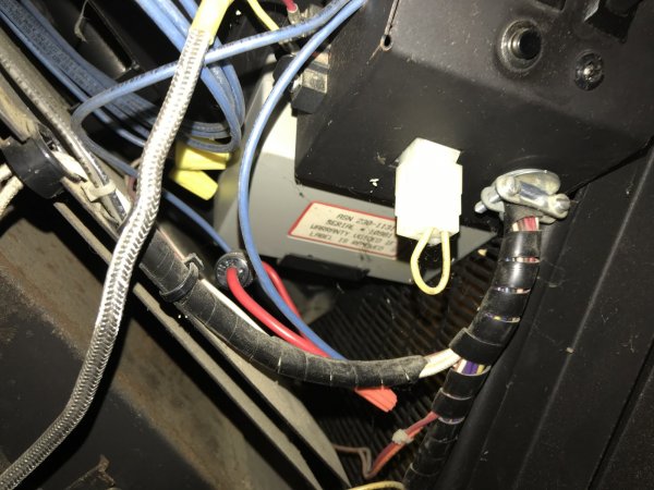

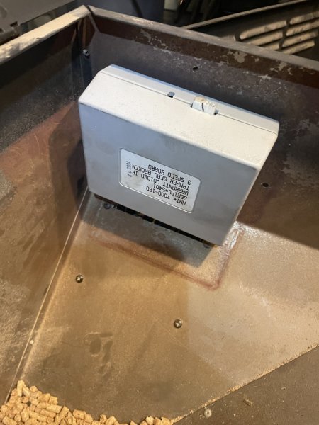

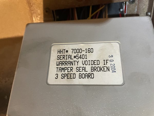

    Hello

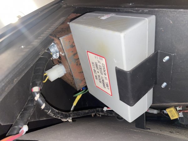

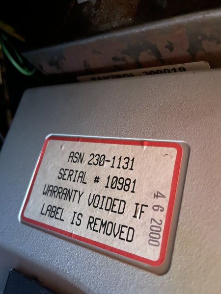

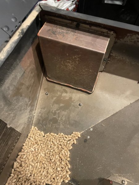

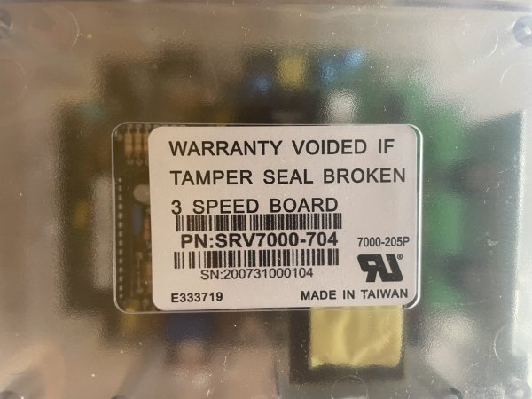

    One other caveat here is that the Aladdin and older HHT CB1200 Classic Bay stoves had the old non translucent gray control box. HHT came out with a new updated translucent or clear control box with some good improvements.
    1. There was no real start cycle circuit so if the heat level switch is set to low, and the stove is in a very cold place, then the stove may not have enough heat and vacuum to turn the safety switches ( vacuum switch and low limit ) on before the 15 minute time out kicks off. The reset button can be pressed to give it more time and then it will start unless the auger chute was completely empty of pellets then it may take one more press of the reset button to get the stove started. This occurrence can also be avoided by having the heat level switch set to medium or high.
    The new clear control box can easily installed to replace the old gray box to resolve this issue.
    2. The model selector switch will flash a blue light in this clear box that can easily be seen to show which model stove the box is programmed for.
    3. There is an amber light that flashes sometimes when the stove does not start to show the thermocouple is broken on not making proper contact with the screw terminal block to make fault diagnosis much easier.
    The original sticker in the hopper before 1998 is Aladdin Steel Products
    The sticker in the hopper in 1998 was changed to Aladdin Hearth Products when HHT purchased the company
    Pic 1-3 C 1200 Aladdin control box under hopper
    Pic 4 - 6 CB1200 HHT control box in hopper
    Pic 7 - 8 Updated 3 speed clear control box
