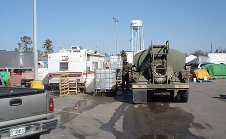

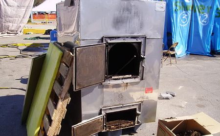

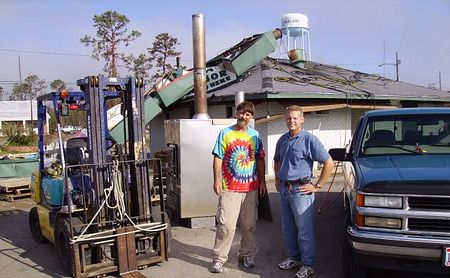

    After Katrina in Waveland, MS Hardy donated a stove to heat shower water. We literally set up 6 shower stall made from pallets and blue tarps in a destroyed Fred's(dollar type store), parking lot. The Hardy supplied the hot water from totes using a jet pump. Water came from the National Guard. We had one mixing valve so everyone got the same temperature. PICT0252.jpg thehomestead_wehaditgood-2.jpg PICT0260.jpg PICT0261.jpg
