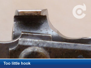

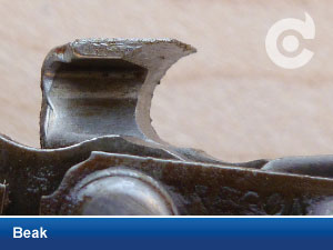

    While it’s probably good practice, each cutter does not need to be the same length, at all. If you use a progressive raker/depth gauge, your chain will cut perfectly straight if 1/2 of them are at the end and 1/2 are new.
    I think the most important aspect to sharpening is #1, raker maintenance and #2 the angles of the working corner. If you don’t have the proper “hook”, the chain is either going to cut like grease lightning for a little bit and get dull fast, or it’s going to cut slow for a long period of time. Finding that balance is key.
    I’d post pics to show what I mean but unless you use square filed/ground they might not help.
    These angles are for cutting clean soft wood. It’ll be fast, but won’t last long (this is by choice).
    This pic would be the equivalent of raising your file up higher in the cutter, creating less hook. Much more durable.
    So in retrospect, I’m going to say behind rakers, the position of the round file (up and down) is the second most important. This is why you see so many guides that position the files height on the tooth.
    Too much hook.
    Not enough hook.

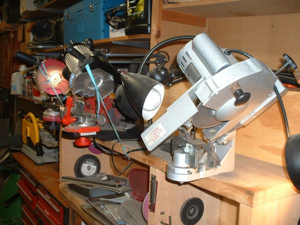

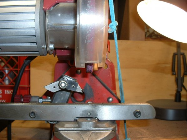

    The only thing I would add is making sure the raker maintains the same contour as the factory grind and of course the correct progressive angle. Not how the wheel was contoured with a diamond.

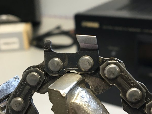

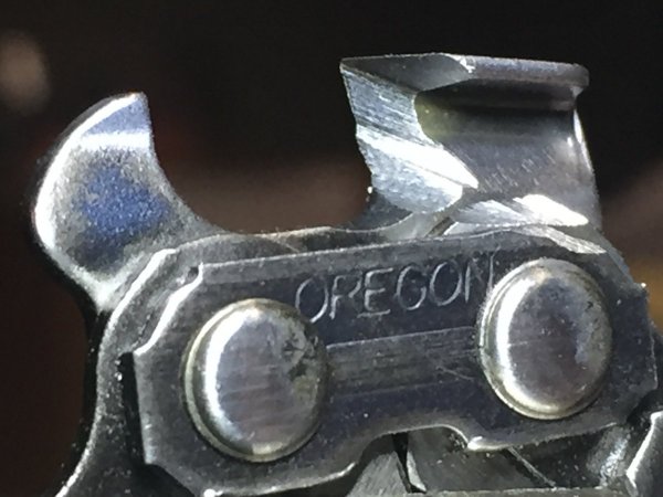

  12. The Wood Wolverine
    17,938
    113,950
    How my doing?
    :eek::D

    Sorry to confuse. This chain is for going fast in square wood. But I really cleared out said gullet. ;)
