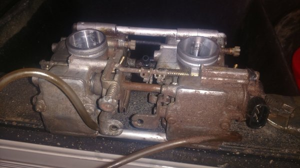

    2006 Polaris 600. Mikuni flatside carbs.
    57xx miles.
    Never have I cleaned these carbs. I do run e free when it's all that's available on the trail. But it mostly see's ethanol and sits all summer with Ethanol.
    Dirty I'd say so. Almost 6k miles of belt dust.

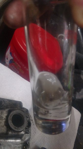

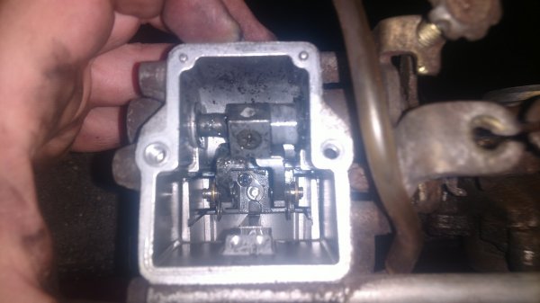

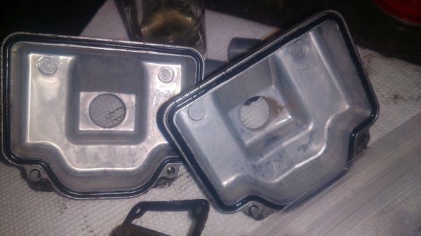

    IMG_20180217_213502745.jpg top side of carb has some grey slime. Pto side.
    water traps had "grey water" look to them. With a bunch of dirt.
    Bowls look good.(where all the water should sit) And no I didn't clean them yet.
    All this Ethanol destruction!!!!!!:rofl: :lol:
    Off to clean the Jets and reassemble!
