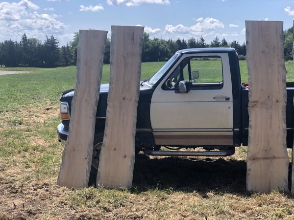

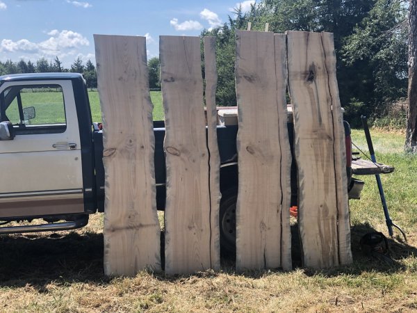

    This was one of my first endeavors into the CSM. Can of whoop ash and a mill =
    This was my latest. Black gum, cherry and poplar

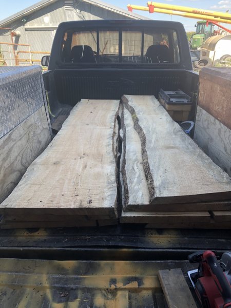

    Here is my Granberg 24” Alaskan Saw mill on my 661 with 28” bar, I use a 24” on smaller logs.
    I milled this Ponderosa Pine with a full chisel chain & didn’t have any problems. I have 2 of the GB milling chains that I used on some Mulberry & Cherry but I agree with The Wood Wolverine you don’t need the milling chains & the Vacuum Cleaner/Sewing Machine company saws are better suited for milling. Northern Tool is where I bought my mill/rail system, although a nice straight aluminum ladder will work for the rail system.

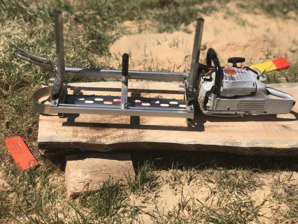

    As seen in pics, I use a Granberg mkiii (I believe). The newer version is better with the billet pieces. I did end up breaking one of mine but Granberg replaced as a defective part. They were great to deal with.
    CSMing is hard work. Searching around here will net some good tips. It’s best to elevate one end of your log to help push the mill through. And one of the best tips I found was using a leaf blower strategically placed to direct fumes away from you.

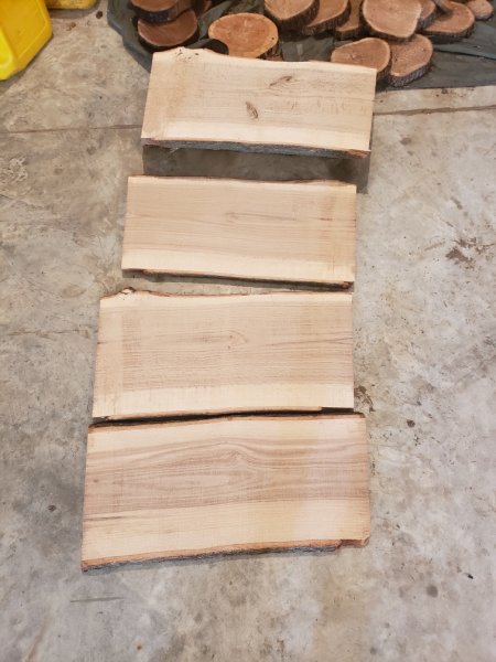

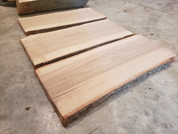

    First cuts on some oak with my mill. Not perfectly flat but good enough for my first cuts. I can see why you'd want a leather saw for milling. It was definitely hard on my saw. I think my oiler might have gotten plugged up. If I can sell enough boards I'd buy another saw for it but not sure what I'd get. This was a chunk of red oak I found down at the city tree dump.

    Yes it is rough on equipment ( and the operator ) for sure.
    I didn't go back through this entire thread to see if anyone had mentioned to turn your oiler up to max ( if you have that option ) and run your mix a little heavy on the oil. I personally run 40:1 but believe others might actually run even more oil.
    Have fun with it.
