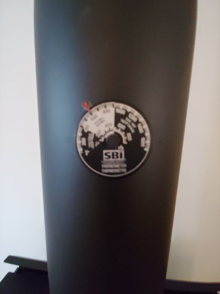

    Currently 115F, sometimes as low as 9o-94F...18” off the stove. :rofl: :lol:
    However, I’m cheating a little...:D
