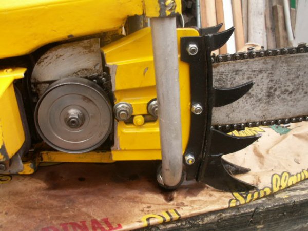

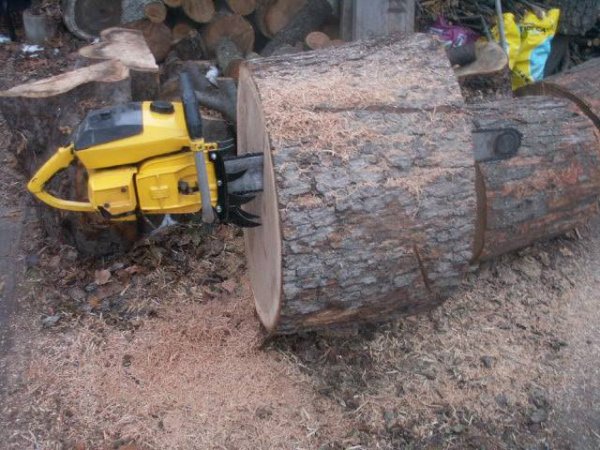

    Was tired of shavings plugging up original clutch cover on my McCulloch Super Pro 125C,so I acquired a beat up one off a mid 60's 200 series model & made a few modifications with 4.5" grinder & extra thin cut off wheel.... mac 125C dec 2013 31 inch white oak huge spikes.jpg modified mac 125c clutch cover.JPG

    Meaning?
