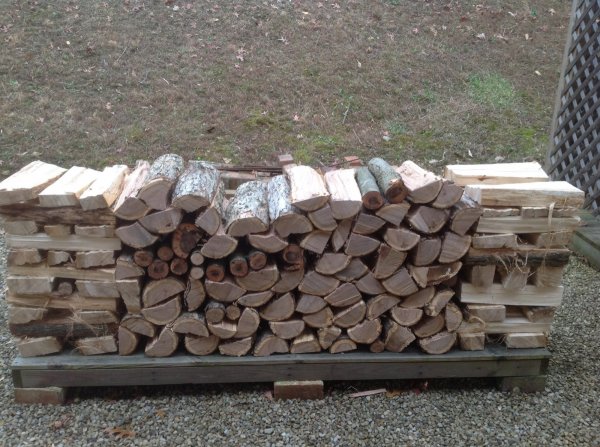

    Welcome to the Forum!
    There's quite a few guys here that regularly get dead standing wood or fallen tree damaged wood and the short answer is that it depends. Sometimes it can be almost perfectly dry and other times not even close. I have had red oaks that were bone dry and others sopping wet even after being dead for years. Being directly on the ground or dead standing makes a difference also.
    Red oak and red elm both give you a visual ( you can see the moisture in the color of the wood) after splitting that gives some indication of how dry it is along with the weight in your hand of course. A moisture meter used correctly is a better indicator in my opinion for what your trying to do. I personally think red elm and white oak are fanatastic firewood. I have found the red elms to quickly lose all their bark and be very rot resisitant and it doesn't surprise me your finding nice dry, barkless red elms that have been dead for some time. Great firewood!
    As others have said, I think your red elm is go to go at 16% and the white oak would benefit from more seasoning at 24%. I just cut a dead standing white oak that read 22% and it's in my stack now for a more seasoning, since I know it will come down a bit from there.
    The white oak I just cut is in the center of this stack and was dead standing for a few years, already starting to develop a little punk in the sapwood.
