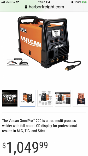

    Did u get a 120 or 240 VAC welder? Is it a mig, tig or stick?
    In my workshop, I wired in a 50 amp outlet for my HF Omni Pro 220. I put in a 125 amp sub panel in my boiler room for an instant electric DHW panel to switch off the oil boiler if the price of oil goes way up. So I put the 50 amp breaker in there for the welder and just ran the 6 guage wire to my workshop. The 30 amp sub panel in my workshop runs everything else. :) Welder has a Nice digital display screen that calculates wire speed and voltage when I enter the guage of the metal to weld. I did have to bump up the voltage when I welded Stainless Steel to steel and then bump down the voltage when I welded my muffler back on to my tailpipe when it fell off so I would not blow thru it.
    Search Results For "Omnipro 220"
