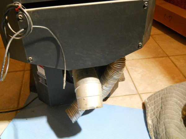

    hmm wondering if they put an adapter 3>4" adapter ? This one is a 2011 model if i may ask what year is your P43 ? Unfortunately the owner with the p43 has not responded yet (via email) Have to act this weekend on it as the cold weather is coming starting next Monday.
    Thanks Dew for your response and one more question how much does your stove weigh if you know .
    thanks !

    The P43 should only need 3" venting, if under the 15 ft. limit - if more, then 4" venting is needed.
    Source: http://downloads.hearthnhome.com/installManuals/P43.pdf
    page 9

    re: adapter - yeah, most venting systems offer either the 3" or 4" appliance adapter, so if the length requirements are good for your install (and the existing adapter fits the new stove), just swap over the adapter, easy peasy.. And sell the 4" adapter on CL. :yes:

    Mine is a 2010 Model. I had to get the 3" to 4" adapter because I'm over the 15Ft limit for 3". But the exhaust port on the stove comes from the factory at 3". I'm able to move my P43 by myself with a handcart when needed.

    My P43 is a 3" exhaust also. That must have an adapter on it.

    Luney have you been to look at that P43 yet? I am familiar with the CL ad the photo you posted came from. The stove has been listed for sale almost a year now (maybe longer). At first the price was $1500, now it's $1200, and the ad was updated once or twice with "$1000 if you come buy it this weekend". Seems odd that it's been sitting for so long, start to wonder if there is something wrong with it, not mentioned in the CL ad.
