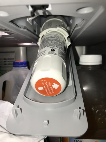

    The water filter change light came on in our new refrigerator and all I did was open the compartment that holds the water filter and closed the compartment and the change light went off! Is this change light on a 6 month timer? New filters are $45.00 Same Brand filter as a whirlpool. We only had the refrigerator for 6 months! Fridge is a KitchenAid.
    Will the filter actually last much longer? We have good water, can I use it without a filter?

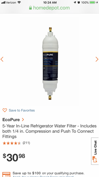

    According to this water filter ad, the filters should last 5 years not 6 months!!!! See pic 2 !!!

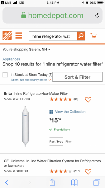

    The last option is to get the bypass cap and then buy the much cheaper inline filter at Home Depot?
    https://www.homedepot.com/p/GE-Universal-In-line-Water-Filtration-System-for-Refrigerators-or-Icemakers-GXRTDR/202073877?cm_mmc=Shopping|G|VF|D26P|26-9_WATER_TREATMENTS|NA|LIA|Air&WaterQuality|71700000052725342|58700005047623356|92700044092941849&gclid=EAIaIQobChMI9N2_qIaP4wIVSv_jBx03BQqsEAQYBSABEgKUr_D_BwE&gclsrc=aw.ds

    I would pick any option besides ignore replacing it. Drinking water that has passed thru a old filter full of filtered out crap is filthy, disgusting and pretty much gambling on the filter's capacity for filtering out pathogens that are breeding in that nutrient rich old filter.
    Betcha 5 bucks that manufacturers guarantee for lasting 5 years does not cover actually filtering filthy water.
    This is why many refrigerator manufacturers put a 6 month timer reminder on the filter.

    Home Depot has some inexpensive inline filters like this one. $15

    I have Frigidaire. Water filters just "get clogged" eventually.
    How that happens I'm not sure.
    Ice cubes just get smaller and smaller.
    I cut one of the filters apart and could find nothing built up in it.
    Even city water can't be that full of stuff.
    I think the charcoal just eventually clogs the outlet and it's done.
    Good for business.
    I got the bypass. Works great. Plenty of ice.
