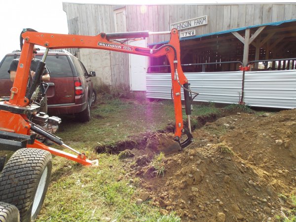

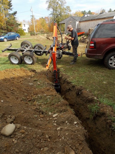

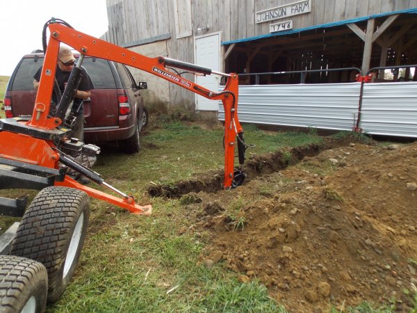

    Water Line with Backhoe
    I was pretty impressed with this. 300 feet of water line, four feet down with a foot bucket equates to about 60 yards of soil. This was tough digging with the same gravelly loam and never excavated before. I won't say it is fast, as that would be a lie, but I think its this little machines ability to always fill the bucket...and I mean always fill it...that makes it productive. Every time it comes out of the trench it is heaped up with soil and that is where it really is effective at digging. Its not an excavator, and its not going to dig a foundation for a house, but it SURE BEATS A SHOVEL. Total time was about ten hours which seems rather obnoxious, until you factor in the costs too do so. I used 3 gallons of gas to pull this off, so at $2.09 a gallon, it cost me $6.27. That is pretty good because it was a job that you would be hard pressed to find a contractor to do (too small) and they would inevitably charge more then $6.27 to do it.
    The key to digging I found out was in using the outriggers at just the right time. By keeping one or the other at maximum extension, you can really roll the trailer over so you can either dig deeper into the ground, or deeper under the hitch so you don't have to move as often. (see pictures) The best angle of attack is 90 degrees to the trailer/towing rig. I should note that I have spare hydraulics so it would be easy enough to build a hydraulic thumb for this, but with the grapple it has, and a 15 time span to change out the backhoe or grapple, there may not be a need too.
    Tow Rig:
    I found most of the time I actually use my Ford Explorer as a tow rig as it it just plain faster then my farm tractor or bulldozer.

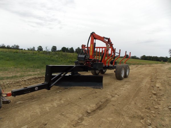

    A year later the Wallenstein continues to be something I use everyday. Equally I seem to be using its chassis to build additional implements to get things done around the farm. In this case I was able to build a grader blade that bolted to the hitch. By bolting a 6 foot section into the hitch as needed, this gives me a VERY long length that makes roads very smooth in plane. With the trailers walking beam suspension, it also means anytime a rock gets kicked up by the blade, the wheels roll up and over it yet the blade remains flat. I have found 1-2 passes are all that is required to smooth my roads.
    So this is just another use it has around the farm.

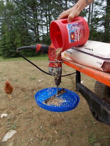

    This machine has already paid for itself.
    Being a farm, we got a grant from the USDA-NRCS to stop some major erosion that was occurring in one of our fields. This included building an access road, constructing swales, and seeding down a field. Using its dump body, grapple, backhoe, grader blade, and other modifications we used this for every aspect of that work, including moving 350 cubic yards from our gravel pit 1/2 mile away. Since I could do everything with this log trailer, we got the entire amount of the grant money without having to use contractors.
    Here it is modified as a seed spreader for sowing down our field.
