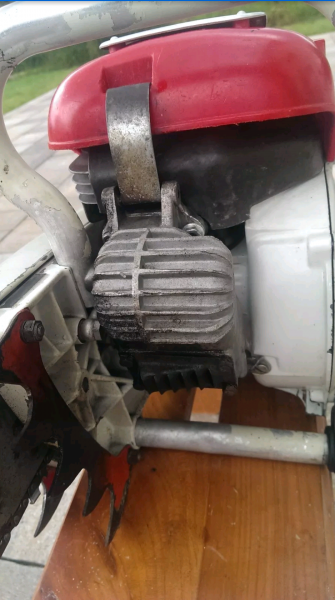

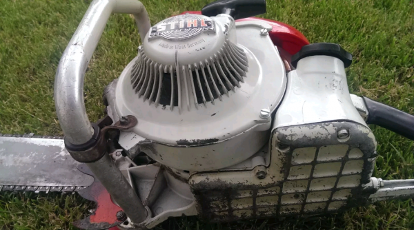

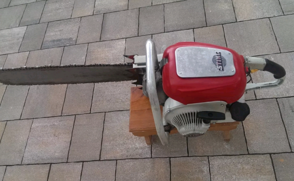

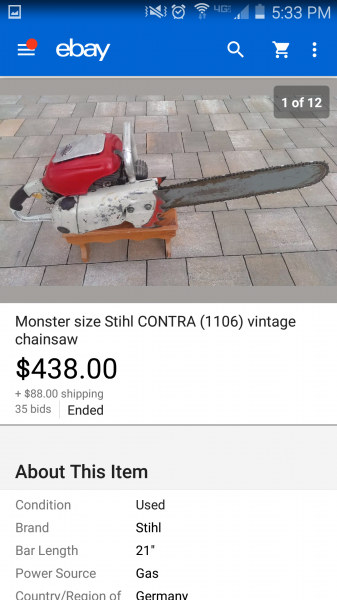

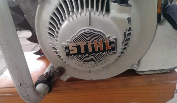

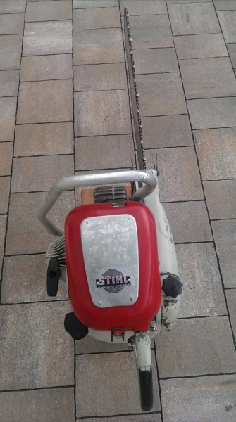

    ......found this baby on ebay the other day and I pulled the trigger.....it's a circa-1960 Stihl Contra. 106cc. In very nice condition!
    Now, decisions decisions.....should I hop it up with the 66mm P/C and turn it into a full-blown 090, do I restore it to its original glory or do I just plug some simple mods to it and keep it as-is?
    It's reported to be a good running saw and as you can see from the pics, she ain't beat up at all. I'm kinda excited.....

    You don't see those much. Looks to be in great shape too. Great score!

    Scotty, I just found this post, that's a nice looking Contra. A couple things to think about, if you put an 090 top end on it, your red top cover will no longer work. An 090 spark plug screws directly down through the top of the cylinder, so you'd have to put 090 shrouds on it. Then you have the issue with the buckles that hold the top on, you'd have to take them off or let them flop around. Now, if you want to put a 137cc Contra S top end on it, chances are the P&C will cost as much as you paid for the whole saw, then you have to find the Contra S metal cylinder shroud that goes between the cylinder and the red top cover, and all I have to say about that is, good luck. The Contra S specific parts don't come around often, and when they do, they are pricey. If you want a 137cc Contra, I'd leave yours alone and buy a Contra S when one shows up. I think your saw is newer than a 1959, or at least has a newer recoil. What does the air cleaner look like?
