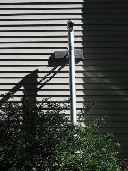

    My 2 cents that's the way I would go ,it's what I did EZ to clean I don't really have a wind issue the end cap can rotate from left to right mine is pointed away from the wind .

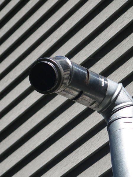

    I had a problem with my Enerzone because it was mounted horizontally (3' up and 2' out). and the wind shut it down a few times. I added a 45° to the end of the horizontal last year and it was enough to not have a single problem.

    looks good, and I dont know if you'd ever have an issue with it, but birds tend to see those round dark holes as homes in the off-burning months and can actually try to inhabit your pipe...a few years ago, we had a call from a guy who's stove wouldn't feed. We pulled the combustion blower cover in the stove, and pulled out six dead sparrows clogging the exhaust....apparently they followed the pipe in to the combustion blower, but couldn't turn around and expired there. I guess I would suggest considering a fairly open spark arrester (1/2" squares?), or covering the exhaust in the off-months...if you do use an arrestor, just make sure you give it a periodic cleaning...they can plug
