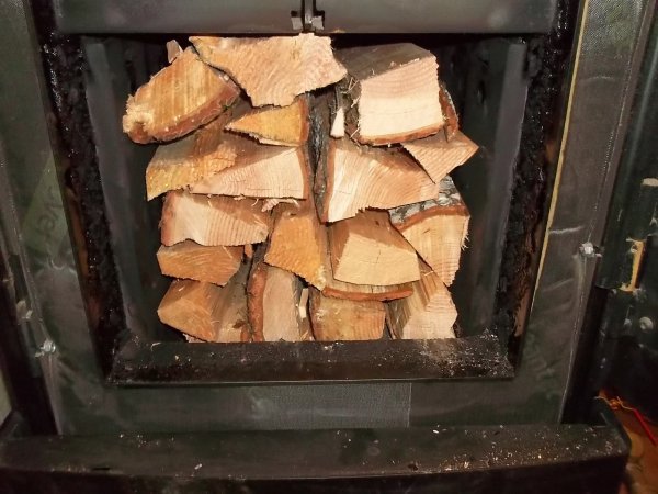

    The load 5 cubic feet .

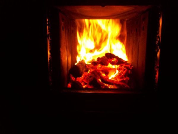

    Half way through a batch burn (90 minutes), has raised a 1045 imperial gallon tank 24 degrees !

    Out of curiosity, do you remember water temperature before and after the burn ? I'm assuming you are burning that much to cover a 24 hour heating period.

    Storage (1045 imp Gallons) was 145 degrees and was raised 45 degrees to 190 degrees. Storage will easily last 24 hours closer to 36 hours. It has taken me almost 2 years to learn how much wood to use for a batch burn and not idle the boiler!

    A full load will burn in 3 hours at 160,000 BTU's !

    Have you ever considered weighing the load? Weight x 8600, then deduct (18-20%?) for moisture content, and boiler efficiency (mid-upper 80's?) should equal BTU's put into the tank...at least as long as you know the wood is dry, and I'm sure yours is...

    When the storage tank was put into the boiler room it was set up for a boiler the size of a dishwasher with the bigger dimension-ed boiler , an electric wood splitter ,and a big shop vac there is no room for the scale , but I have weighed the wood several to see what efficiency of the boiler was , 3% t0 94% ! The firewood is 13% to 14% moisture content.

    I have 1045 imperial gallons stored. When the tank is up to temperature at 194 degrees F, it represents 1,500,000 BTUs with a heat loss of 3,000 BTUs per hour or roughly .24%, so I'm guessing 2,000 would be about as big as you would want to go - a number that Garn has chosen.
    I like to fire the Vedolux when storage is down to 145 degrees F, then one full charge 0f wood (5 cubic feet) gets storage back up to 188 - 194 degrees with no idling.
    It takes about 5 minutes to light the boiler.
    I fired the Vedolux at 10:00 am Tuesday, no fire Wednesday, and will fire again Thursday about the same time, so that's 2 days of heat and domestic hot water on 5 cubic feet of wood. We are having some really mild weather so the house is only drawing around 10,000 BTUs per hour.

    In your particular setup, simple math tells me that if you had 2k gallons of storage you would need roughly 10 cubic feet of wood to get the 2k gallons of storage up to your target temperature from 145° F. Based off of your picture it doesn't look like your boiler holds that much wood. In a hypothetical situation would you load on top of hot coals, or do you have to start another fire from scratch ?

    This boiler only holds 5 cubic feet. When it gets down to a good coal bed, more wood can be added. I add wood when the top of the coals are even with the bottom of the loading door. It will take a hour to burn these coals and raise the tank 15 degrees or roughly 150,000 BTUs.
    The Vedolux holds 3.0 cubic feet. The boiler that I have - the Vedolux 450 holds 5 cubic feet and the Vedolux 650 holds 7.5 cubic feet.
