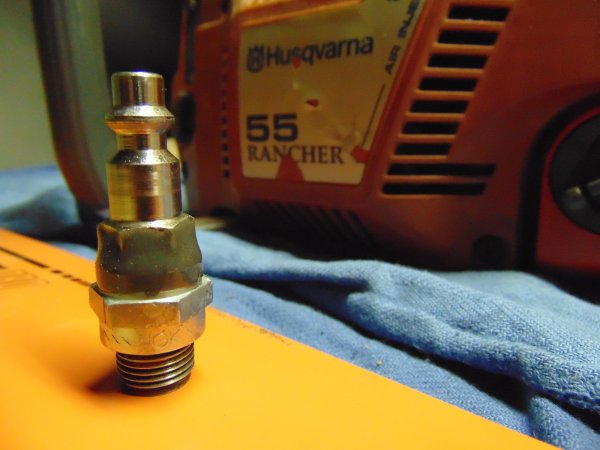

I use the inner tube rubber at the muff and carb and the mightyvac. Use an old plug by breaking out the porcelain and JB'd an air fitting. Then tubing to that. It was cheap...
I have the mityvac shown above, as well as rubber wedges and a spark plug adapter front fordf150. On a saw with an external impulse, you don't need the spark plug adapter
