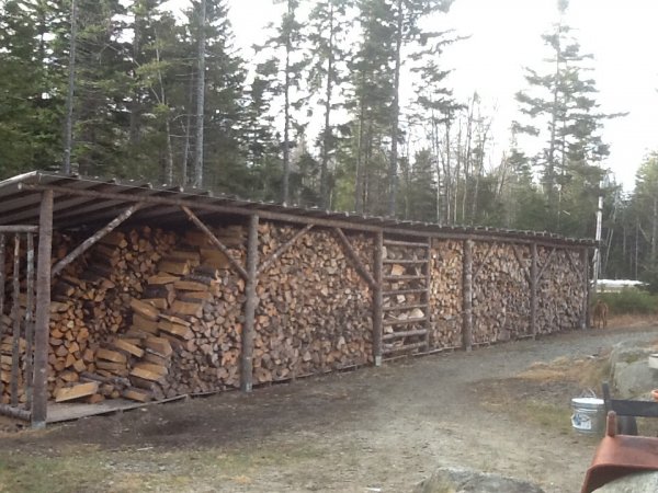

    Kidding aside I’d like to do the same. I have said it before but I really like DaveGunter ’s shed made from logs. I’d like to construct something similar but it’s project 1137 on the list right now.

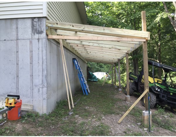

    Im building a leanto for a friend who lets me store wood at his place. I have nine cord stacked in his front woods. His piles are very hastily stacked and covered. All over and different color tarps. I offered to build a lean to for him to hold 4-5 cord.
    4'x36' framed with PT 2x10's on cinder blocks. Roof beam at least 6' off grade on both sides for head clearance. 2x4 posts, 2x6 rafters & beams. 1x4 roof strapping. 12' aluminum roof panels to be cut in half. Everything for the build was scrounged except the 2x10's which i got for 90% off at Lowes. May have to buy some nails and screws so $60-70 out of pocket for the project. I will post a thread when started and update progress.

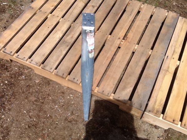

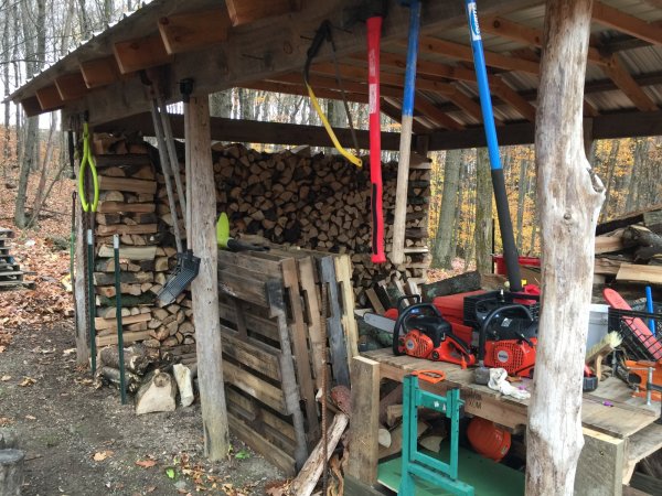

    It sure did save on lumber $, but it was way more time and effort to source the poles and deal with non dimensional wood during construction. I used "Oz-posts" to keep the poles out of the ground. They worked pretty good and are still holding solid. They will likely twist or go off plumb when you drive them in unless your soil is very forgiving...so using them with dimensions posts will likely throw things off.

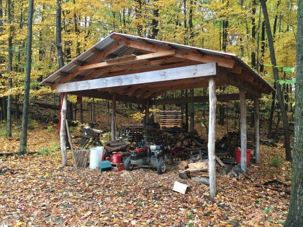

    Locust if ya got it. My larger woodshed is simply 5-6" dia. locust posts set into the ground 4 feet. I expect it will last decades.

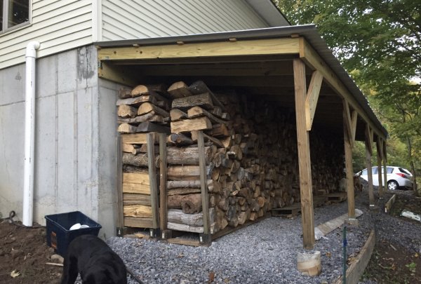

    I built this three summers ago after storing 10 cords under tarps and on pallets.... 38 ft long by roughly 9 ft wide. I think it’s 7ft high against the wall and 6 ish at the front. I am not a carpenter but I did this over a week after work. I got a low fine gravel for the floor and set the wood directly on it. It cost some money, but looks neat and clean. I also thru up three 12VDC lights on a dollar charged battery system for night work. The other logic I used is that I rely solely on wood for heat, so I need wood dry and clean. Tarps work but they somehow sag and build water and ice. Ruined wood sets Me off! Good luck with your build!!!! 02A1C481-943A-43E7-8496-89F3B5E27514.jpeg 6437DF23-9717-4182-B794-D7774F3434D6.jpeg
