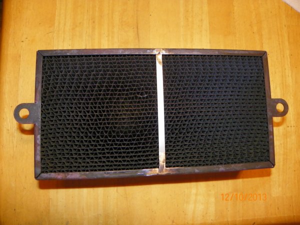

    Here is a picture of a steel cat. The cast cat has larger an square holes.
    Definitely check to make sure you did seal the tee when you put it in.
    Remember too that lots of folks never took the time to learn how to run a cat stove. Shoot I know many never even looked at a manual and probably never moved that little lever to engage or clos the cat. As for the rough treatment, get some super fine steel wool to go over the scratches. Get the finest you can get (It skips me right now but I think that is a #4.) You can always call Woodstock to double check that. Tell them Dennis' memory has gone on strike.

    Solid advise from Backwoods as usual. Easy to tell if it is a old cat since they were mounted in 2 piece cast cast enclosure. New steel ones are one piece like the picture from Dennis. We are running the steel cat and while it works well, I like the old cast unit. We did install a probe to monitor the cat. Woodstock provides a hole in the back of the stove for this purpose. While this is not necessary, I like watching the temps rapidly climp as the cat fires up. Not uncommon to see 900+ degrees behind the cat with a stove top temp of 500 or so. All in all, the Fireview is simple to operate and very efficient. Enjoy yours!

    The cat is a 2 piece one. Thanks!
