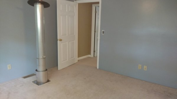

    After ten years of complaining about the layout of our upstairs we got ambitious and I decided to get it started. Our house has never had a master bedroom. It's a 4 bedroom house and each bedroom has an attached small full bathroom. The back corner bedroom had a stove pipe that runs right up the middle back wall of the bedroom for the stove and was exposed (it was like that when I bought the house.) I usually just kept the door shut on that bedroom and used it to get ready for work in the morning since I leave at 5am.

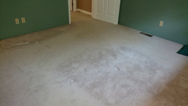

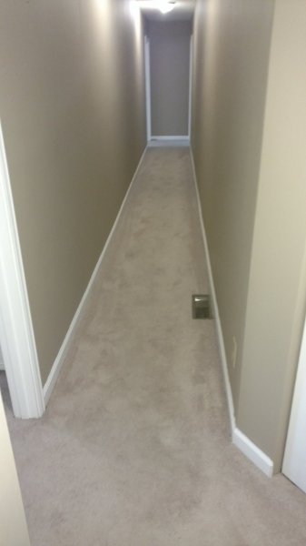

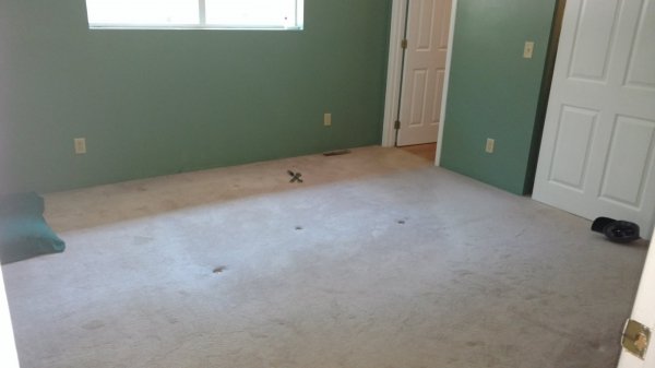

    Anyhow we decided to blow out the walls between the two bedrooms and make a big master with a his and hers bathroom. Here is what it looked like after moving out the furniture right before starting demo.
    Stair well.
    Looking down the hall from top of stairs.
    Bedroom we never used.
    Our bedroom

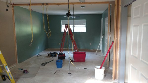

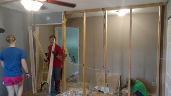

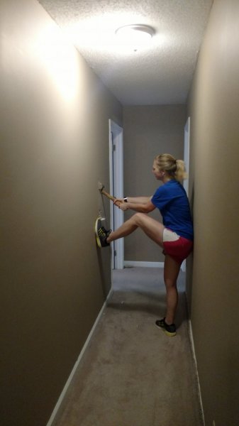

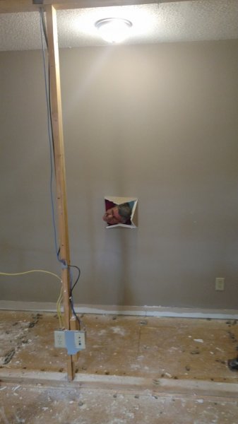

    Demo day! My dad came over to assist which was much appreciated!
    My wife watches way to much HGTV! She wanted to do the whole sledge through the wall thing so she got her way and afterwards we did it my way so there wasn't tons of tiny pieces of drywall lol
    Walls coming down. Lots and lots of rewiring to be done.......

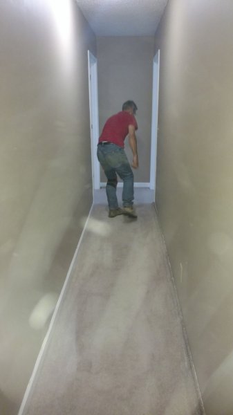

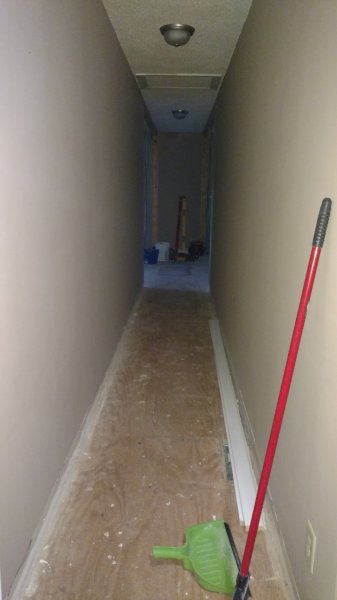

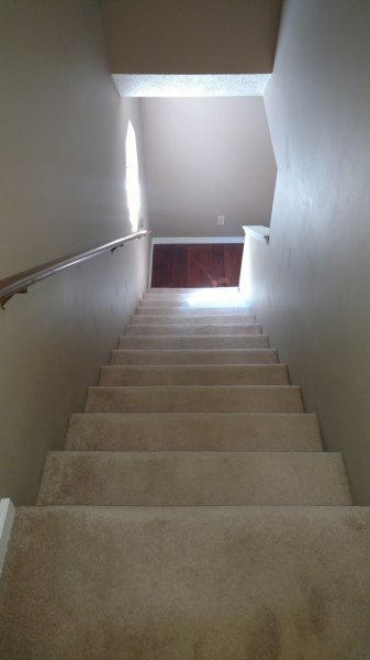

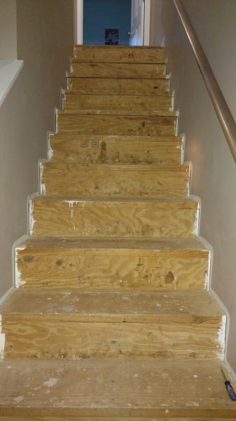

    Stairs and hall were had all the carpet ripped out also. Putting wood floors and all new trim back in.

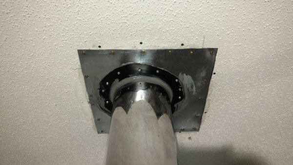

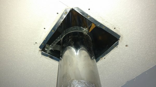

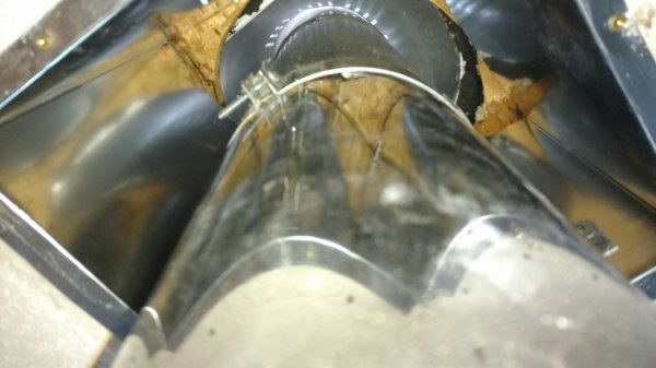

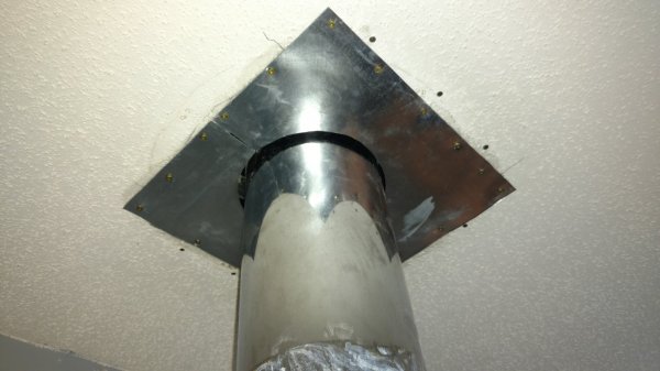

    Before I could work on framing in the chimney and adding another closet I found an issue with the chimney install that wasn't done by me. From the attic it looked like the chimney had shielding around it to give the needed clearance to combustibles but when I dropped the trim ring I wasn't real happy. It had been half way done and hacked together they had used a piece of sheet metal round duct work and cut it in multiple places so the insulation could pour in around the bracketing that holds the chimney.
    Needless to say I corrected the issue. I built a proper piece of duct work for an insulation shield and installed it so it goes to the roof line. I also called the chimney manufacturer and went through the needed clearances and ensured all clearance we're exceeded.
    IMG_20170829_143552016.jpg IMG_20170829_143609632.jpg IMG_20170829_143600222.jpg IMG_20170829_160724684.jpg IMG_20170829_202500737.jpg

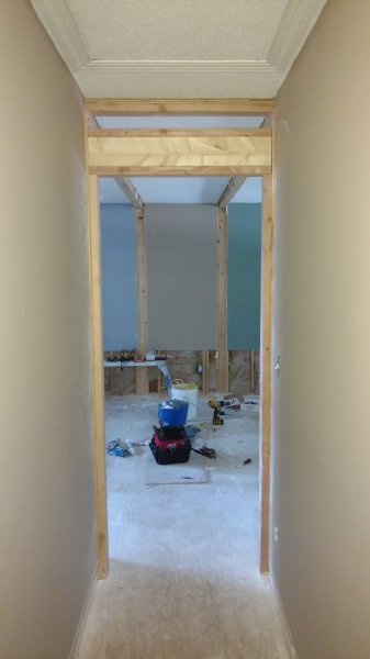

    Next I worked on framing in the closet and chimney. Didn't take a lot of pictures of this part but you can see the results. The chimney is now cased and this closet is going to be a built in dresser more or less. I didn't take the chimney casing all the way to the wall since there was a floor register for the AC there that couldn't be moved. I will be building custom shelves in the cubby for storage.
    Also framed in the new doorway to the bedroom. If you look back past the doorway you can see I took out some drywall on the bottom of the wall to add extra electric outlets.

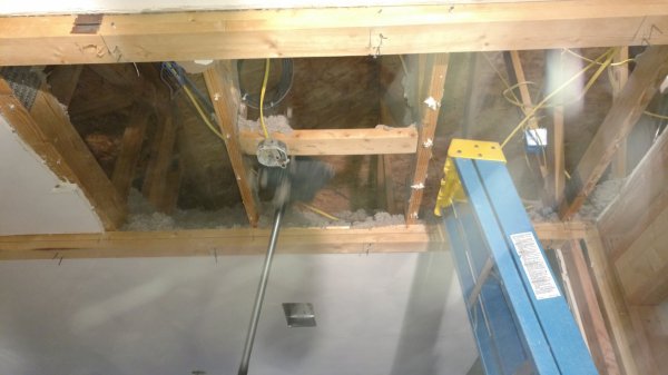

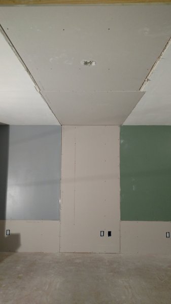

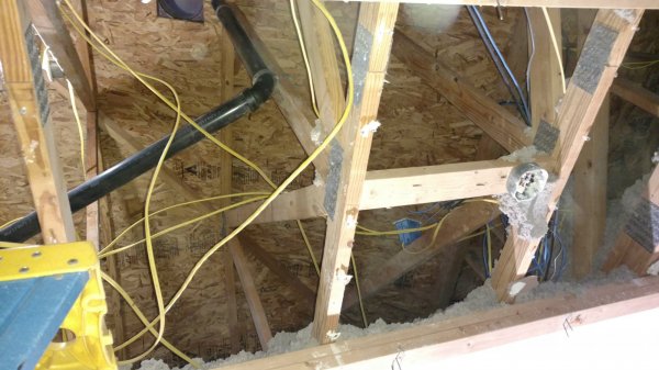

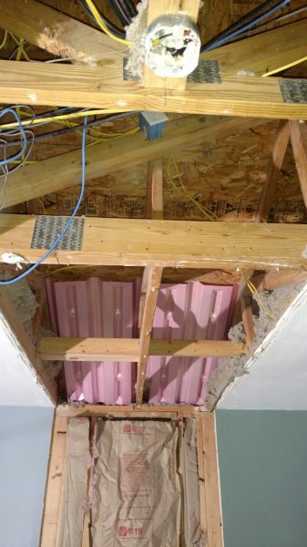

    After ripping the top plate of the walls off it was obvious a section of the ceiling was coming down to get the drywall back up correctly since 2/3 of both walls just had nailers attached between the hipped rafters. Up in the attic I went to shovel back as much insulation as possible. After clearing it back I just ripped out the drywall and let the rest of the insulation fall. We bagged up what fell and put it back when we were done.
    Patched back in. I probably should have done this differently and I'm betting I will regret this later.

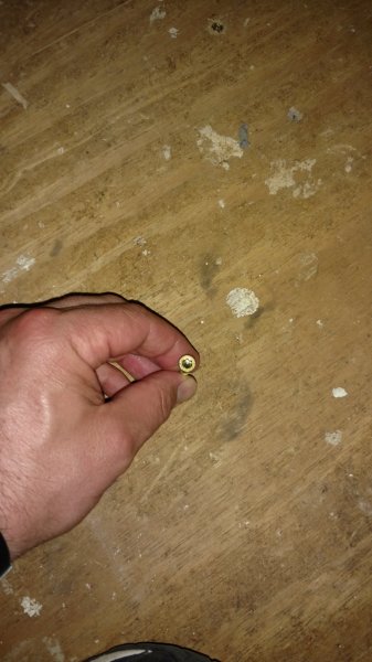

    I then turned my attention to the floors and since I hate squeaky floors and mine had a few squeaky spots I fastened them down every 9" with 3.5" fasteners that have serrated threads. I'm happy to report there are no squeaky spots now :rofl: :lol:

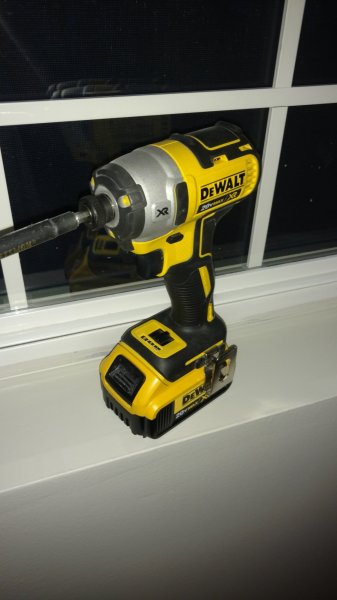

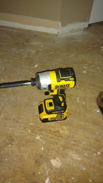

    Also I decide to splurge on a new toy ops I mean tool.

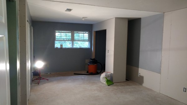

    I didn't take a lot of pictures of the painting process as we were painting in a rush in between volleyball practice and volleyball tournaments.
    I did spray the ceiling in the whole upstairs and the closets with a commercial paint sprayer and let me tell you it was fast! I sprayed close to 800 sq foot of ceilings and there closets in under an hour. Once the ceilings we're done we rolled the walls. The only pic I have from all of that is my wife suited up to help spray. She would kill me if she knew I was posting this :rofl: :lol:

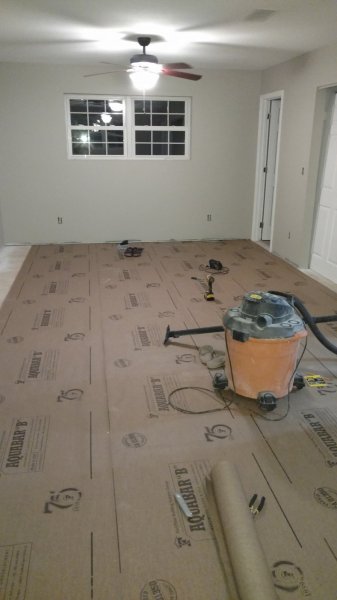

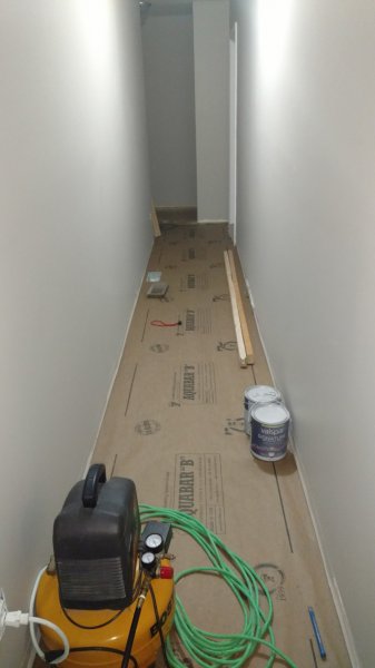

    After finishing the painting I scraped the floors by hand to level everything off and remove any mud or paint leftover from the previous work. Then I put down the aquabar floor covering in prep for the wood floors. You can see the painted wall color in the background.

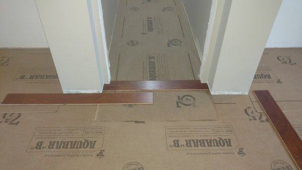

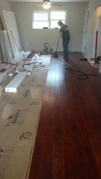

    Anyhow here was the start to laying the wood floors. I'm laying the bedroom wood floor perpendicular to the hallway and I'm going to tie in the hall to the bedroom with no transition so I took me a while to lay it all out. I had to square the first piece to the bedroom doorway and then square the stairs to the bedroom door way ended up having g to split the difference but it did turn out great.
    Once everything was squared up I snapped chalk lines, the ripped down 2x4s a ND fastened them to the floor to give myself a solid edge to nail the first pieces up against and keep everything straight.
