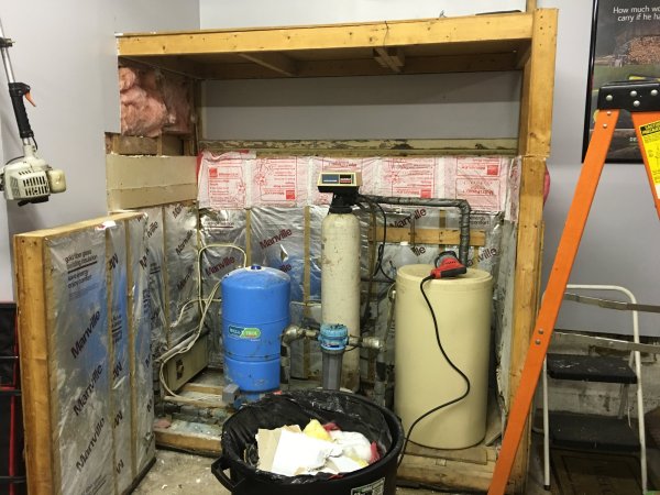

    So SWMBO has decreed that our water is to bad to ignore any longer and declared a new water conditioning system should be installed.
    My old system was installed in a goofy insulated plywood box enclosure that became a mold factory every summer as the system condensated with zero ventilation. And after a pump replacement/upgrade last spring, I've noticed that the cycle time for the pump is pretty short. To make a long story longer, I decided in addition to simply replacing my defunct water softener, the entire system and the mechanical room needed to be addressed.
    So here we go.
    The top is already off the box in this pic but you can kind of see what we had. Things look a lot cleaner in these pics than what actually was. Originally the pressure tank, and the softener were wrapped I. Pink fiberglass insulation as an attempt to insulate them. Removing that sopping mess was fun when I discovered it a few years ago. Note that the box appears to built into the wall of the mech room. The wall was actually built around the box!
    Just one example of the corrosion happening in here.
    The box was equipped with this little heater to keep the system from freezing as my garage is insulated but not heated.
    Interesting note, that's foam rubber HVAC insulation on the main water line. All of my pipes are wrapped in the stuff which wouldn't be a bad thing as it has a higher R value and is much more expensive than the typical poly-foam insulation. Too bad it's all ruined with a healthy 5-6 layers of duct tape or I'd re-use any of it I have removed.
    Creative..... And a royal PITA to demo..... I actually disassembled much of these walls and the box and we burnt the pieces for a couple shoulder season fires.

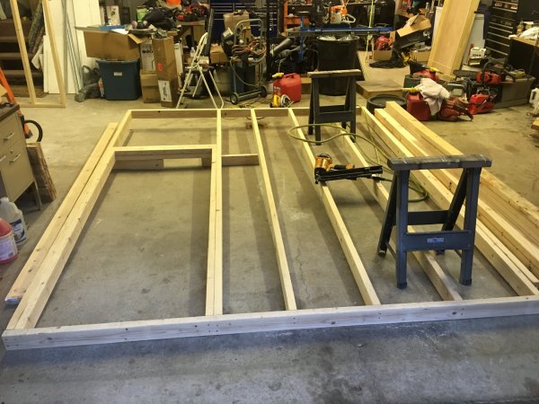

    Framing in progress on one of two new walls. I actually quite like the process, especially with my FIL's framing gun.

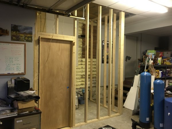

    Walls are up, I apologize but due to the other crap in my disaster of a garage, I couldn't get a great angle on this. But you can see the entire new section. The door is just temporarily wedged in place. Was the most out of the way place to keep it!
    Eagle eyed members will noticed that the electrical is mostly in, at least the in-wall stuff. More on that tomorrow. But this is pretty much where I'm at for now. I'm actually ready for exterior Sheetrock, then insulation and finally interior Sheetrock. But I am painfully slow at this stuff due to a combination of busy work schedule, my ocd, and just not knowing what the heck I'm doing. But I'll keep stumbling through it and posting as I go....

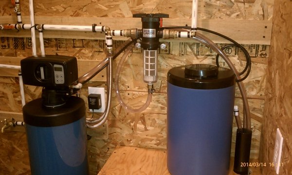

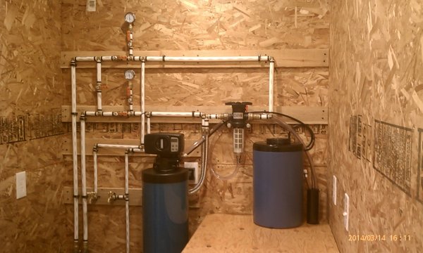

    Oh cool. An aerator iron filter. You must have a good bit of iron. Removing iron is the job of an iron filter and it will help keep your softener from gunking up. Some folks try to use a softener for iron removal which works a little bit for low iron levels.
    I selected the mang-ox filter for iron(plus mang and sulfur) which is basically solid greensand but with a chlorine side tank for backwashing since I could not eliminate the possibility that I may have iron bacteria in my non-chlorinated well water.
    Here's mine. The clear grit filter is now dark orange but none of the iron has made it past that iron filter.
    You can buy the stainless steel semi flexible, high flow, connections between the wall and your filter heads. I don't like hard piping these things.
