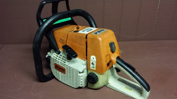

I like it, just a little underwhelmed after owning a (stock at the time) 290 and an MM'ed Echo cs-510 (50cc). All three have 20" bars and sharp full chisels. I bought it off CL a couple of years back. The guy trades chainsaws as a side job. Said he puts a new Ebay non oem piston kit in all of them before selling them just because.? The piston looked good through the exhaust port, this is when he told me it was new. Compression feels good, as good as the other saws and the 290 was bought off CL but looked near new/mint. Air filters are kept clean. I tune them all, it runs great, but I was just a little underwhelmed. I did some timed cuts in red oak with them and don't remember the exact numbers, but very near this: Stock 290 was about 2.5 times faster than my Wild Thang Stock 290 was about a second faster than MM'ed Echo, in a ~24 second cut. 036 was about 4 seconds faster than 290 in ~24 second cut. 20% faster 290 had Stihl chian full chisel, the other two had Windsor full chisel. Walmart Oregon on the WT. Does that sound about right? Was I expecting too much due to 036 hype? I sold the 290 to a friend but can still use it for further testing if needed.
I know I was not impressed with my ms361 after reading all the hype, enough so that I sold it... Aftermarket kits can be hit or miss as well. But 20% faster than a 290 doesn't sound too terribly bad.
Specs show the 036 has about 20% more power, makes sense. When I can I'll retest to verify the numbers.
Some aftermarket kits are undesirable. IMO. Some are good, some are junk. Do you have a compression gauge? I love my 036 and the other 036 I just did (both OEM). Why would he change the OEM cyl? Just because? ? That makes no sense. Take a superior product off and put a less than desirable part on? I am betting he is selling the OEM jugs and making profit on them, and putting the cheapest kit he can get off of the Bay? Or the saws were seized? Then I would be worried that he never pressure tested the engine and the seals may be bad? Have you removed the exhaust cover (4 small T27 screws on the front) and inspected the cyl? I'd be curious. .
He said it had a new piston kit, no new cylinder. I asked. I removed the muffler before buying to inspect the piston, it looked new, this is when he told me it was a new piston, ring, wrist pin. To be honest, before I left with the saw I decided he puts a new piston kit in them because: 1) It was all he knew how to do 2) Its cheap 3) He thought he was doing everyone a favor by "rebuilding" the saws. The guy seemed honest but not knowledgeable, he said as much. I did a quick carb tune on the saw and he was very impressed and asked me to explain the procedure. A friend has a compression gage. Comp test done at full throttle on a warm engine as usual, or cold engine?
I agree with Dex. It may run but maybe not up to Stihl specs. Id look a little deeper before making a final judgement. Keep us posted.
Certain aftermarket cylinders will be of better quality than others. Replacing a top-end just because? Sounds crazy/fishy to me. Check his other listings, does he have a lot of used OEM cylinders for sale? I have a video of my 034 (your 036 should be on the fast side of close) pulling a 20" bar through red oak. Lemme see if I can dig that up.

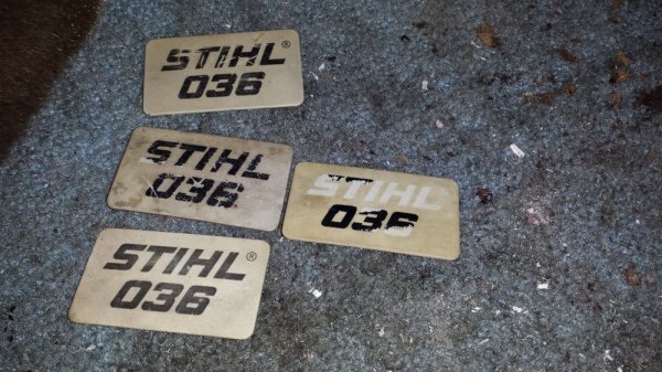

No worries guys. More for me. I have went through a few of them. Here are some of the tags I replaced. This one is gonna hit the block tonight Gotta deal worked with a monkey and need some money
I did the compression test 110 lbs. Cold saw WOT. Then I thought , this saw hasn't been started for 9? months. Maybe its a dry cylinder. Started the saw, revved it a couple of times and rechecked-110 lbs also pulled the muffler and opened it up, piston looks good through the exhaust port. I guess those 8 y/o Chinese girls where doing the best they could when they made the piston kit... Or the cylinder was scored... Or the guy FUBAR'ed the assembly. Or ....... I really don't think the guy knew what he was doing enough to lie about it. Surely he could have come up with something better than, "I put an Ebay piston kit it then just to make sure they are good". Who knows? It runs like a top I'll probably just keep on until my conscience gets the better of me. I retract my 036 bashing
I would check the ring gap too. I've heard of the cheap kits being way out of spec. New piston for that saw won't break the bank if you wanted to replace it. I also wonder what the squish clearance is? Wanna send me the saw? I'll break it down and find out why the compression is so low, you ship it here pay for the new piston if it needs it, I'll ship it back on my dime. I'm real curious as to the range of quality found in aftermarket parts....
MM, I honestly appreciate the offer. That is quiet the offer. I'm not a true mechanic but I've rebuilt a two V8's under the shade tree with reliable results, + lots of single cylinders. I think I'm plenty capable, just need the ambition or need to fix the problem. I'm sure it will get to haunting me. Truly, thanks again.
Not trying to insult your ability Fox, just that I would like to see a "bad" aftermarket part and it's kinda hard to explain to a vendor that you want him to send you a junk part.
The muffler had been gutted, a hollow can, no screen, empty. But the exhaust port hadn't been modified. I opened that up to let it breath better. Won't fix the core problem but what the heck.
