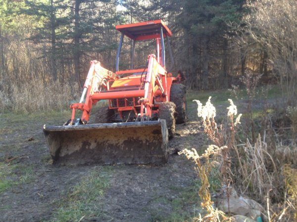

I dug up some dirt and top soil from both sides of the trail in this wet section. Everything going good until I tried to spread it. Can't get enough traction to back drag or push and level it. Dam. Oh well, I should have known, it's coming out of a wet section, it's going to be wet. I'll have to let it set and dry out. The sun hitting it while I'm working it doesn't help. It starts unthawing and turns to muck. Time to move to another area and do some work elsewhere. Beautiful day! The Bota got her feet dirty!
Yep... that freezin' n thawin' thing is a real pain isn't it? Had my pickup in 4x4, at the cabin a few years back, in that slimy crud. Truck just sat there, made slicks for tires with the treads full of muck, then started sliding downhill. Not fun. At least you had your bucket to help you get out.
Wait for it to dry out and freeze up again, drag it with the York rake to break it up, keep driving over it with tractor. I'll get it, it may just take some time. Lots of reasons for it. It is mostly topsoil and clay, so not very easy to spread. Then when it starts to unfreeze, yuk.

Well I made a little more headway this afternoon. I was able to use the hoe and break some of that up for a section of about 20 ft. or so maybe. I just kept breaking it up by digging at it and then swinging the hoe through it from side to side and hitting it with the teeth. I then could back drag it a little. I found some dryer sandy soil up on the hill by the camp and brought about 5 bucket loads down and mixed that into the area I was working. Now I'm just hoping I can continue through the rest of it like that. Still another 40 feet of the clay/muck though. I think I will get some time tomorrow.
