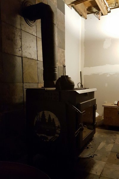

    Just can't stand the thought of going through another winter with the VC 0028. Too much maintenance for me with 2 jobs, it needs a complete tear down and rebuild, and I really need longer burn times. Been leaning toward the Blaze King but at the price they go for I don't care to just jump on one without a little more home work especially if I can get the same job done cheaper.
    The house is well insulated with decent double pane windows, 2000 sq. ft. ranch. We're all gone most days for around 10 hours which is where the burn time come in.
    What do you recommend?

    First and very important question what size is the flue? any other size restrictions..

    Easy. Go to Woodstove.com and look at the Ideal Steel Hybrid.
    You don't need to spend the big bucks to get over 10 hours of heat.

    8" flue and almost no size restrictions. I overbuilt the hearth to handle a stove bigger, badder, better than the VC.
    Looking at the IS now.

    The Ideal Steel takes a 6'' flue to work the best. A call to Woodstock would confirm if it will work well or not on an 8'' flue. In order to get a good stove built for an 8'' flue you are looking at a Blaze King King model $$$. Everything else takes 6" in the Blaze King line. How tall is the chimney?

    I have 8" chimney , 6" pipe to the ceiling works great

    Chimney is 13ish feet now but for less than $200 and a few minutes work it could be at 16' or more but it will look like a cell tower sticking out of our roof so I'd like to keep it like it is if possible. It's too short for the VC according to spec. but it still pulls a decent draft.

    My Buck 91 runs an 8 inch flue.

    How long of burn times are you getting with the Buck? With a 4.4 cuft firebox it must really pump heat.

    4.4 is a little misleading, I think they measure that with the cat shield out. Really about 3, maybe 3.5 around there. I can do 9 to 10 hrs and the blower still running.....11 or a little more and still have enough coals to reload without kindling. I'm always leary to comment on these subjects because then you can talk useable heat, type of wood, etc. all that makes a difference.
