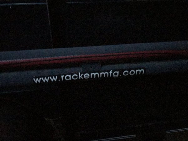

    Went outside and looked at my buddies trailer. I’ve never used it. Similar to yours with a ramp.
    Here’s some pics of what his looks like. A large pin/bolt that comes out of the angle iron pointing to the rear. Hole drilled in it for one of those cleaves pins or whatever they’re called.
    He also installed one of those ramp lifters because his back went out. You may not be interested but I included a pic anyway.
