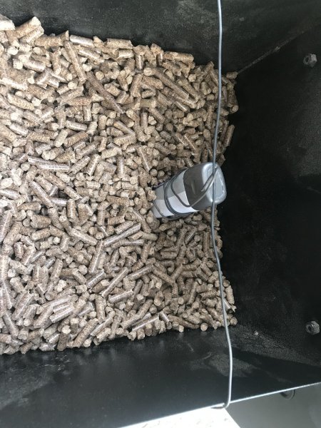

    I mentioned this before in the smoker section... but it happened to me again last weekend. I was at Costco today and saw the rep there and was questioning him... he said it was unusual and to call Service line. I’ve had this smoker for about 9 months now. I’ve had a several over fire and several pot kills. I put a couple of moving blankets on top and fire bricks inside it to try to help control winter coldness ( several readings off the net mention that this helps in the winter time cooking). Which seemed to help. But last Sunday in the middle of a cook. I had a burn out and pellets just pouring out of the pot. Now according to both of the Service tech that I talked to... it’s caused by my Traeger pellets not funneling down (sticking together) and creating a pocket.. burning out the fire then trying to play catch up.... they advised me to run my hand through the pellets every hour to keep this from happening... has any body seen or heard of this with a pellet cooker? If I wanted to play with the smoker every hour I’d have bought a sticker smoker or weldered mine up...:mad:

    I was googling lastnight... Its out there, some have issues and some have never had a issue. I was brainfarting last night about a vibrator to keep things moving. I've seen this at work with some of our materials, where we had to hook up a air controlled vibrator to keep the pellets moving. I'm thinking I've got a old shaver that is battery fed that I'll dangle in the middle or somewhere in the pellets to see if that helps any.... and tie it off to the side of the loader.... I like this darn thing, but its almost to the point of cashing out and moving on....

    Well I haven’t done a real long cook yet, but so far so good with the toilet paper roll & the vibrator (via a old toothbrush)...

    Those pellets look awful long?wonder if it' bridging

    Well look at you, ya handy Macgyver you....:salute:
