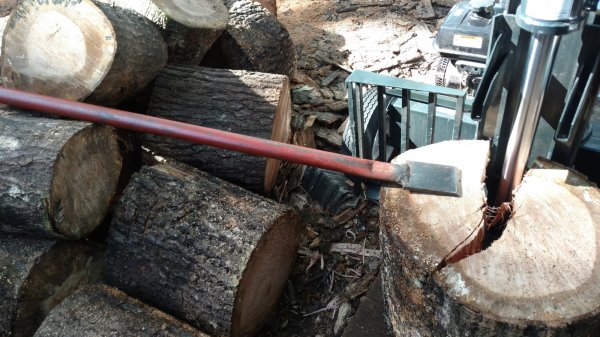

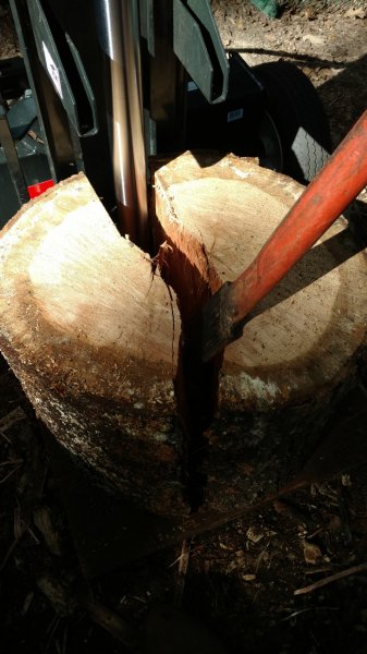

    Just thought we could share some ideas on what we use to help make our favorite lifestyle easier... IMG_20181001_105758683.jpg IMG_20181001_105829790.jpg This is a pry bar/chop stick I made, works great to help slide big rounds around or cut strings down in the split.

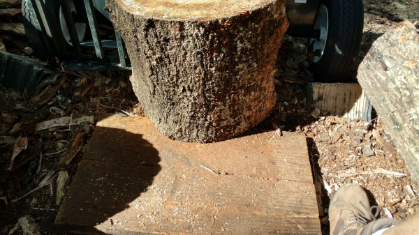

    Small wooden platform built from 2×8 and 2 pieces of decking boards underneath. It is a shade higher than foot of splitter, makes getting bigger pieces on splitter easy. IMG_20180720_132925695.jpg

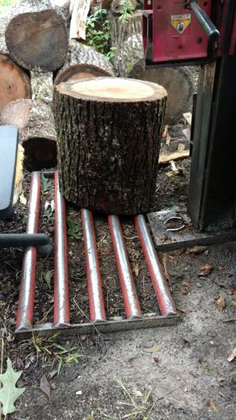

    Metal platform that we use for the big rounds.

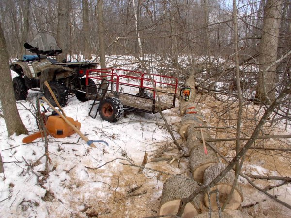

    The pictures show most of the equipment we use, especially the first picture which shows atv, trailer, saw, measuring stick, log tongs, cant hook, pickeroon and wire basket for holding gas, oil, tools and water.

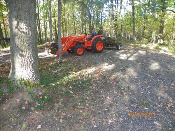

    Below is the tractor with FEL and trailer, although we don't use this trailer much.

    Lots off great tools you have there. I too use a long breaker bar to help bust open big splits and make it easier to move them around. I like the idea of the boards in front of the splitter foot.

    Great thread! I'd say next to my chainsaws & axe, my hookaroon and my tire are my most valued tools. The tamper bar is a great idea for when I'm wedging out the big stuff. Never would have thought of that but just added it to my arsenal. Thanks for the tip!:yes:

    I had one of those, but about 4 inches wider. Was originally for scraping chicken chit off of concrete floors where it got really caked on bad sometimes. I ruined it scraping bark off of pine logs. Bent in just about the same spot as that one. I have some solid bars but at 4 feet they're a bit heavy.

    I think that blade is 3/8×3 or 1/2×3. When we pressed the 1 1/2" pipe flat to weld it, that's how the bend got there. Actually worked out great as it creates an offset. It is pretty heavy, but that helps in chopping, I have used it to debark logs some. That's a workout...

    Pry bar looks like a real useful tool. That can't hook has a history I'd say!

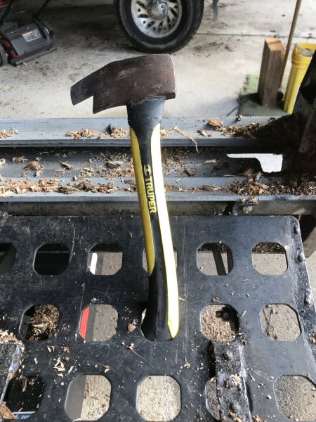

    This hatcharoon has been a life saver. I won’t work without it. It’ll pick up a 100lb round. The flat part of the blade that’s left acts as a release fulcrum. Just smack the handle down and it pops out. One of my most useful tools. Handle did come apart because they used a strong rubber to hold them in. I got all the rubber off and used JB weld to put it back on.
