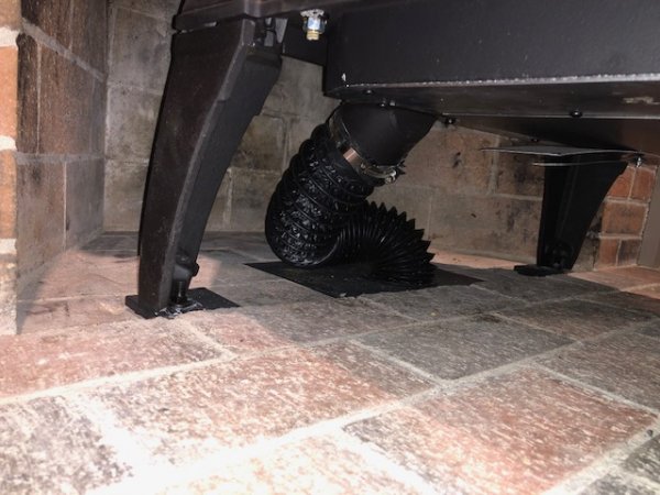

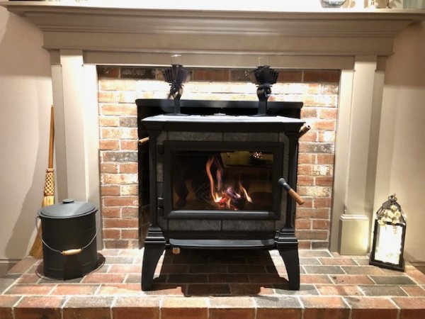

    I've been leaning towards pipe damper, I figure what can it hurt (besides slightly more difficult cleanings). The only problem is that on my setup, the pipe is difficult to access. Not impossible, just difficult. See pic. I mentioned the idea to the stove shop, and they were pretty opposed. Said they could do the install, but most don't need it and it causes a lot of different problems.
    I don't think it's a particularly super strong overdraft as I don't hear that roaring sound some speak of. If I load too much wood, the secondaries grow stronger and bigger, and temp continues to climb, until the wood is fired out.
    What I was wondering was - can I install an INTAKE damper and achieve the same thing? I have an outside air kit on the stove, and it's much easier to access. Could a damper be placed in this tubing to achieve the same affect? See pic.

    Yah, I may do this. Thanks for the info!
