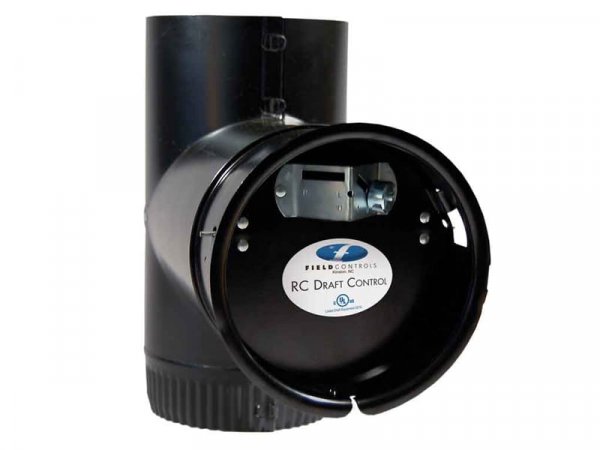

    A barometric draft control, not a damper. Field Controls has them for wood stoves, and although not ideal my idea is to put one on the bottom of the T outside so as not to pump smoke, fumes or CO in the house.

    Interesting idea - it would work to reduce draft pull from the stove -> and transfer it to the baro: although I'd be wary (cautious) of installing the baro outside: due to wind. They're very sensitive.

    A baro draft control inside house would be dangerous,and illegal.Outside it would be useless. I would like to see vid or pics of too much draft.Personally,i find it hard to believe you are keeping the outside pipe that warm to increase the draft very much,except if it already is hot outside.Have you modified anything else on this stove,besides the OA?

    I know they don’t recommend using them on 25’ or less but if a person wanted to test to insure that excess draft is truly the problem one could be constructed easily and cheaply :thumbs:

    looks like about 10-15 dollars worth of parts, using an automotive exhaust pipe adapter fitted to the "T" end-cap / cleanout port.

    Barometric dampers are only made for interior use, and quite common with coal stoves and oil furnaces. As mentioned above, winds would mess with the draft and likely make the baro ineffective. Also, the pivot points would likely rust and render the baro inoperative
