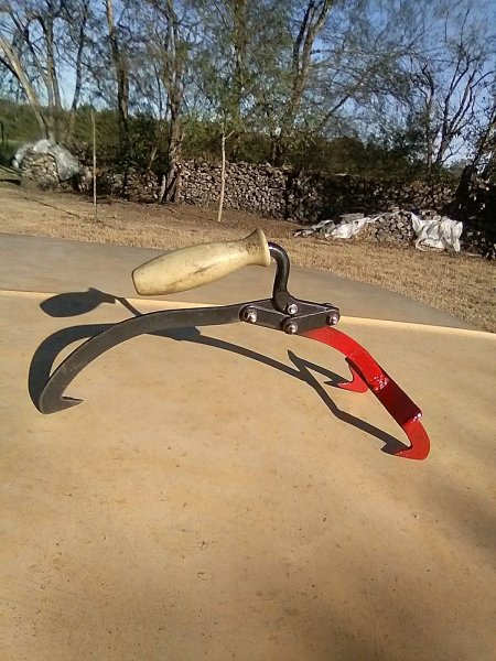

    I liked your idea of the tripod tongs so I copied it using a pair of Timber Tuff tongs.
