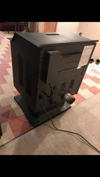

    So there's a hack of a nice st crouix auburn stove I know of. What do you guys think. It's not to far from me and the gentleman said he religiously cleaned this stove. Just wanted a little input from some one who has used one.

    From those pics, stove was taken care of, but I'd like to see in the firebox. BTW, what's he asking for it?

    He was asking $1200 but I managed to get it for $1000. It looks really clean to me. The fire box looks great. Probably only used it a couple seasons.

    It definitely looks very clean on the outside. Can't wait to hear how it runs for you.

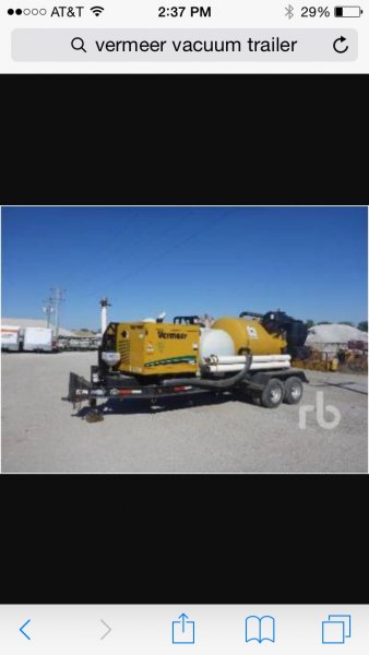

    What do you think of suction instead of blowing? I work for a directional bore company so I have access to a Vermeer vac. Which is basically a giant shop vac. It's made to suck up mud for spotting utilities. This way everything will go inside the vac while you hit the back wall with a rubber hammer.

  18. jtakeman
    12,196
    54,975
    :eek:
    A lil too much suck there! o_O

    That's funny. They do have some suction but not as much as you would think. I think the plus side to using the vac would be that the hose could reach all the way threw the garage and into the basement at my parents house. This would eliminate me trying to get a buddy to help me get it outside to use the leaf blower. I will use the LB for my auburn though.
