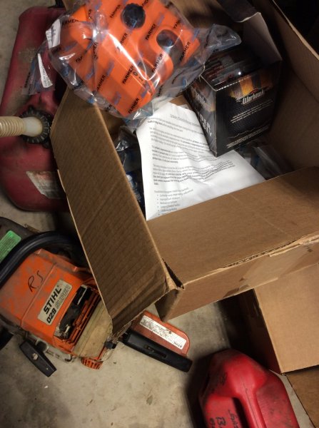

    That’s one of my next projects, converting this 029 Super
    HL Supply had a very specific Deal of the Day last week on 029/290. 039/390 parts last week, so it pushed me in the direction sooner.
    Not sure when I’ll start it.
    Let us know what you decided and send pics!
