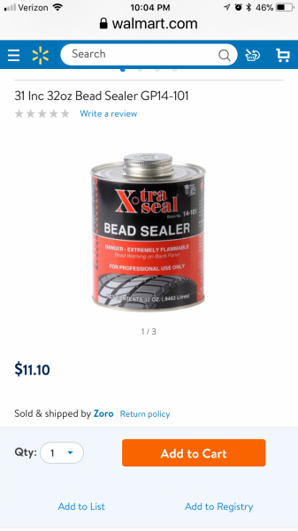

    I have a tire question? My tractor tires loose air after a week but do not have any punctures. It seems that instead of just inflating them, I need to make a better seal of the tire to the rim. When I was young I saw my friend mount tires he would clean the part of the tire that touches the rim with a paint brush and soapy water. Walmart has a bearing sealer solution that looks like it contains patroleum products because it is so flammable?
    What should I do?
    Here is more info I found,
    How to Stop Leak on Tire Rim Seal

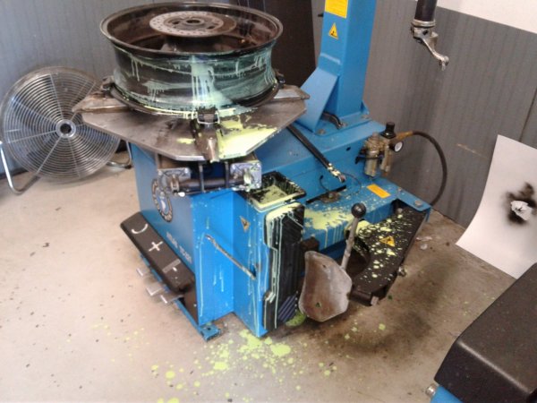

    Slime is good stuff. I won't use it on auto tires though, especially if you have tpms.
  20. The Wood Wolverine
    15,819
    97,614
    For all the guys that use Slime, please tell the tire shop it's in there. :handshake:
