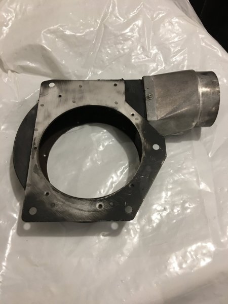

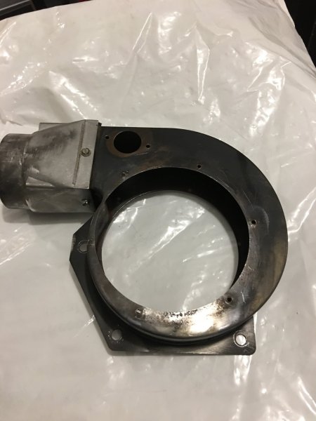

    These housing do get scratched and dirty & dingy The ones that are painted black like Travis Avalon & Lopi stoves, the paint flakes and chips!

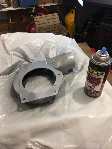

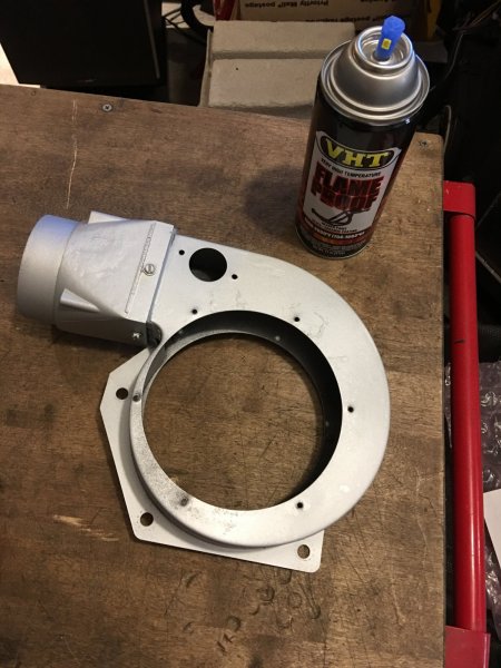

    So here is a Travis housing that I like to repaint with VHT 2,000 Deg Auto header paint from the auto parts store.
    What do you do? Just clean or repaint?

    The header paint is great stuff..
    I have used it on a couple rebuilds myself.

    Pic's look great

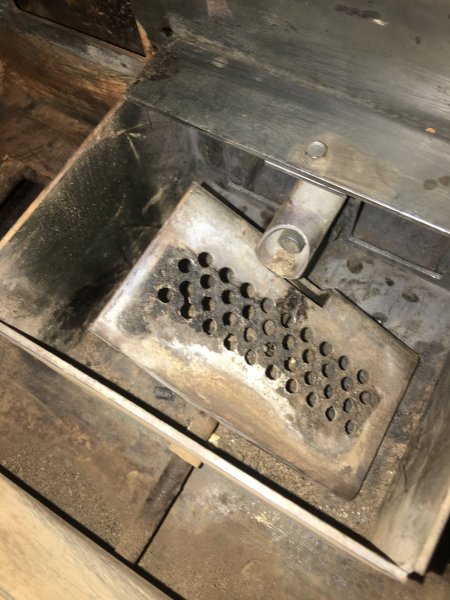

    I just Refurbished a St Croix Prescott with the moving bottom in the Burn pot called the versa grate. I changed the hole pattern on the mounting bracket so instead of using the small versa motor, I can use a standard gear box auger motor that is stronger and easier to get,
    The versa grate is made to keep the corn ash from fusing together but I was wondering if it would be good to burn the nut shells?
    Pic 1 - shows the burn pot sides removed and the shaker grate riding on the rod that moves back and forth. The Igniter tube goes into the burn pot when it is installed.
